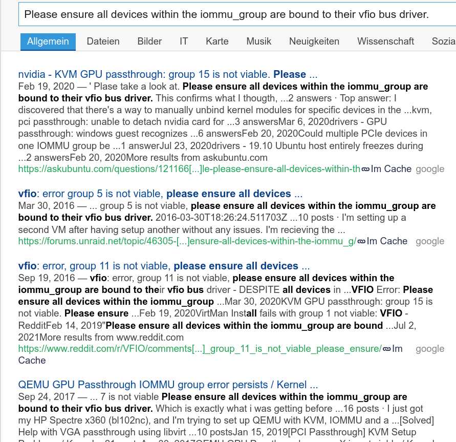

Now I am facing error: Please ensure all devices within the iommu_group are bound to their vfio bus driver.
Anyone know how to fix it ?
ERROR Details
Error starting domain: internal error: qemu unexpectedly closed the monitor: 2021-07-04T19:03:16.171493Z qemu-system-x86_64: warning: This feature depends on other features that were not requested: CPUID.8000000AH:EDX.svme-addr-chk [bit 28]
2021-07-04T19:03:16.171717Z qemu-system-x86_64: warning: This feature depends on other features that were not requested: CPUID.8000000AH:EDX.svme-addr-chk [bit 28]
2021-07-04T19:03:16.171898Z qemu-system-x86_64: warning: This feature depends on other features that were not requested: CPUID.8000000AH:EDX.svme-addr-chk [bit 28]
2021-07-04T19:03:16.172307Z qemu-system-x86_64: warning: This feature depends on other features that were not requested: CPUID.8000000AH:EDX.svme-addr-chk [bit 28]
2021-07-04T19:03:16.198190Z qemu-system-x86_64: -device vfio-pci,host=0000:02:00.1,id=hostdev0,bus=pci.6,addr=0x0: vfio 0000:02:00.1: group 0 is not viable
