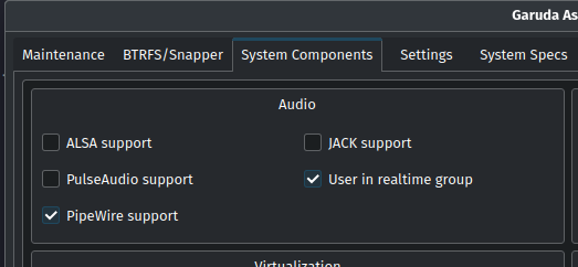

As a beginner myself, maybe Garuda Assistant might help:
Screenshot_20240316_185315
