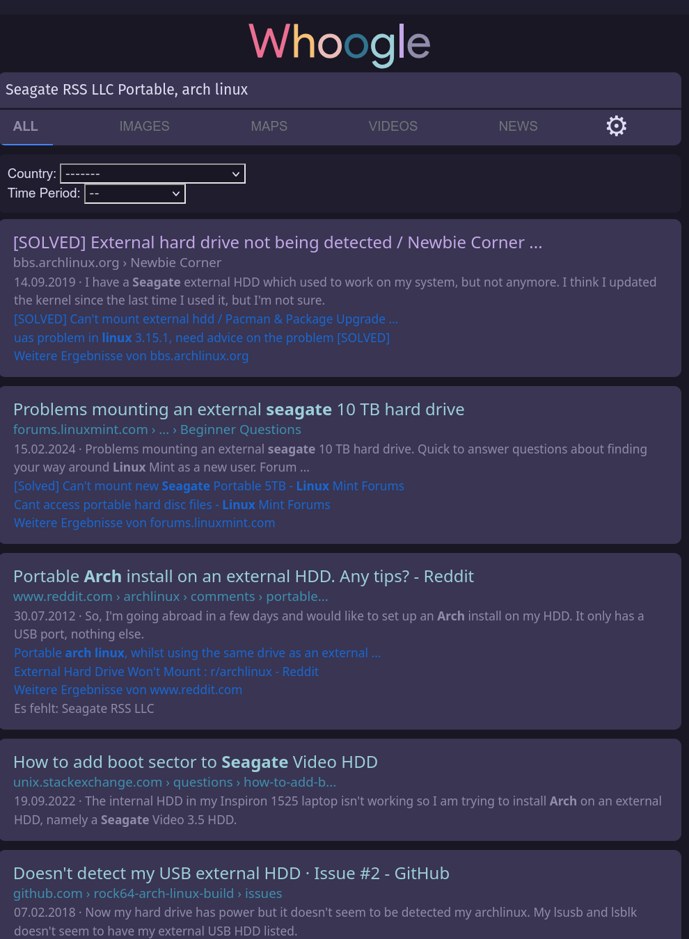

Maybe [SOLVED] External hard drive not being detected / Newbie Corner / Arch Linux Forums
Or check more with Whoogle :slight_smile:
