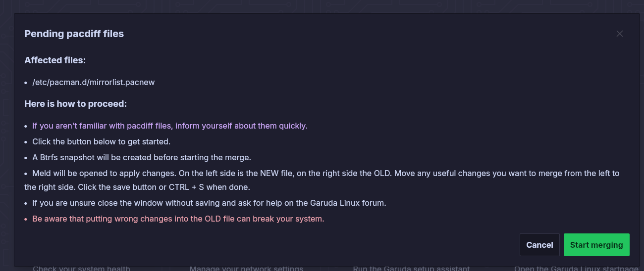

In Rani i got this. This appeared also the first the issues came up. I have never seen whit pacdiff. I am not sure what I did the last time there. I am not very familiar with this part of Arch, but nothing ever broke on Arch for me before (I have been using it for 1 year maybe).

It is explained here:
Basically, you have to carefully merge the updates in the new configuration files into your current files, avoiding to simply overwrite your files, otherwise you’d loose your configurations.
Anyway, for the mirrorlist, this merge is not so important, because the mirrors are selected automatically during garuda-update by rate-mirrors, so we don’t select them manually.
