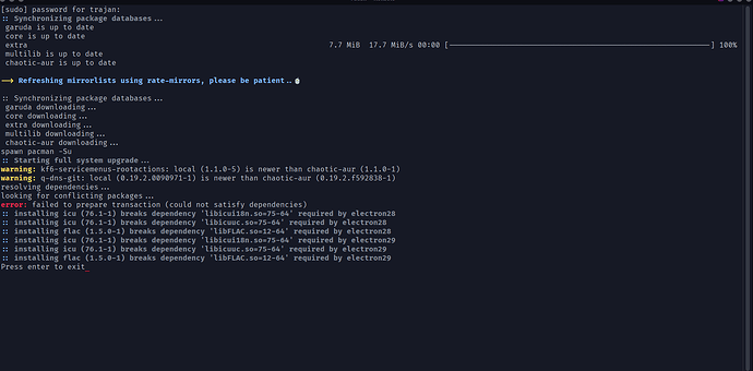

Update Failed | installing icu (76.1-1) breaks dependency 'libicui18n.so=75-64' required by electron28

It says why it failed, sure I could remove the programs but I’m worried that will cause more problems that it’ll solve. Wanted advice as I’m pretty new
Remove old electron28 and 29.
Please no picture from terminal and use search function before you open a help request.
sudo pacman -R electron28 electron29
