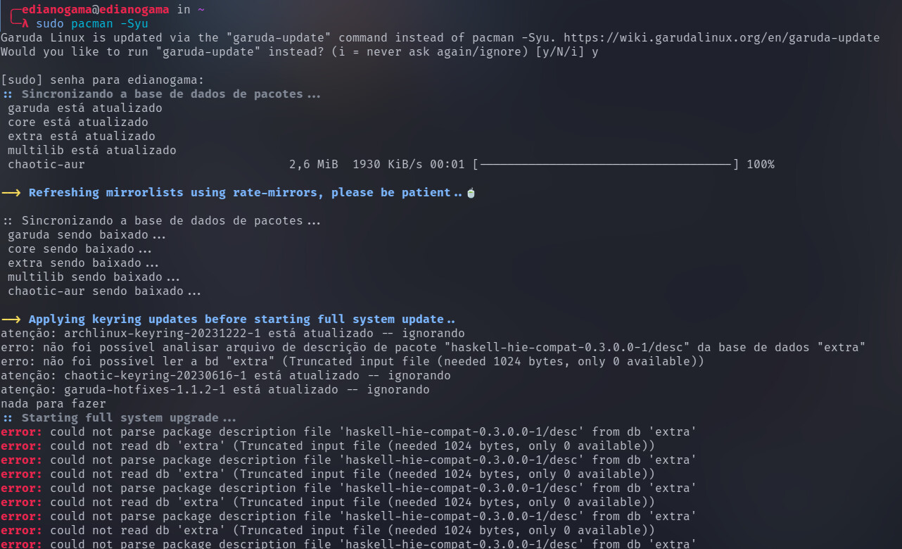

Update error - extra db
error: could not parse package description file ‘haskell-hie-compat-0.3.0.0-1/desc’ from db ‘extra’
I don’t know how to solve this error on extra db.
I tried different ways to update garuda, but none is working.
Can someone help ?
everything started with discord asking me for an update, but garuda is not permitting because of this error.
Thanks a lot.
