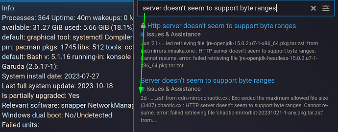

My search-fu is weak! I was looking for the wrong error.
Followed the instructions at https://aur.chaotic.cx/ and update ran via Octopi
