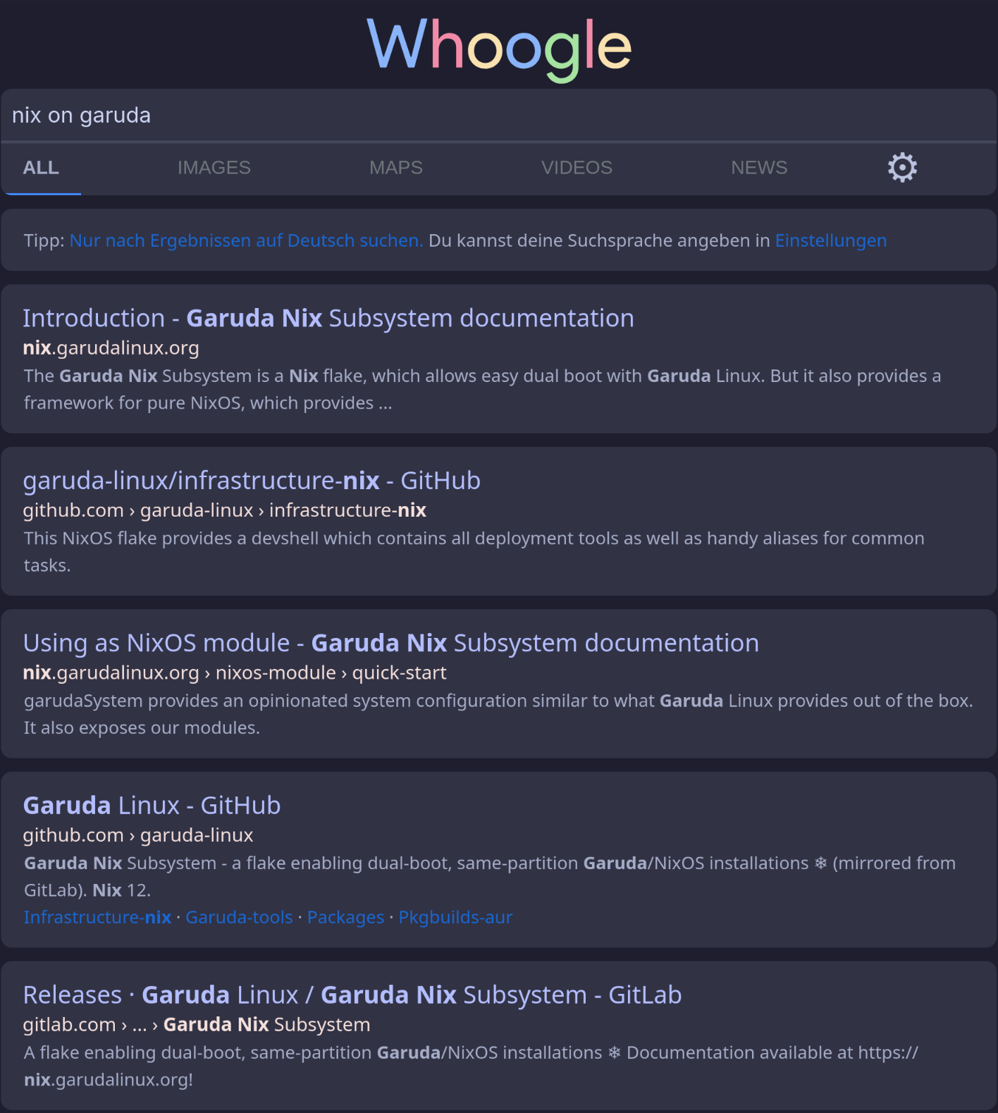

I understand all this. Which is why I don’ understand why i see these different flavors. Clearly we could have Nix and Hyprland. And, Nix is not just a package manager, it’s an OS.
We not but you can use
but it is not supported by Garuda.
Why the total tradeoffs?
What is the difference between having Garuda Nix flavor and going hyprland as the windo/tiling manager and going Garuda Hyprland and then using Nix as a package manager?
Maybe you know the distinction, but I can’t tell from having spent the last week wanting to be your avid customer.
No matter what you want to use now, Garuda does not officially support it.
Neither dual boot nor a NixOS with Hyprland or Hyprland/Nix.
install garuda add the subsystem in your nixconfig add hyprland and log in to it with new user takes no time at all. Or install nixos install the garuda module add hyperland to the config. If you want the garuda hyperland look grab the configs off the gitlab. add the programs for the config items to your config. its not that hard if you understand nix a little or just linux.
