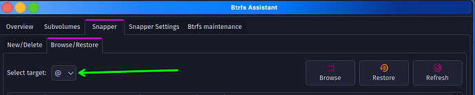

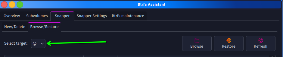

You can restore from the desktop via btrfs assistant or snapper.
If in the future you cant login and the grub snapshot is bugged. You can restore from the LiveISO just mount the root drive via dolphin or terminal after boot. An use btrfs assistant to restore you might have to select your root system in the box below.
Aye, that was the plan in case all else failed.
The error i got when i tried to restore from grub was that it failed to start switch root. Seemingly from missing an os-release file. Ill probably be digging into this a bit more during the next weekend, post another thread about that specific issue.
