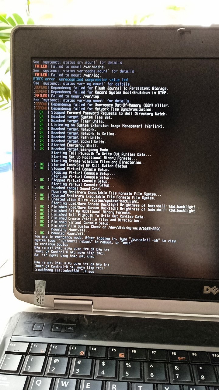

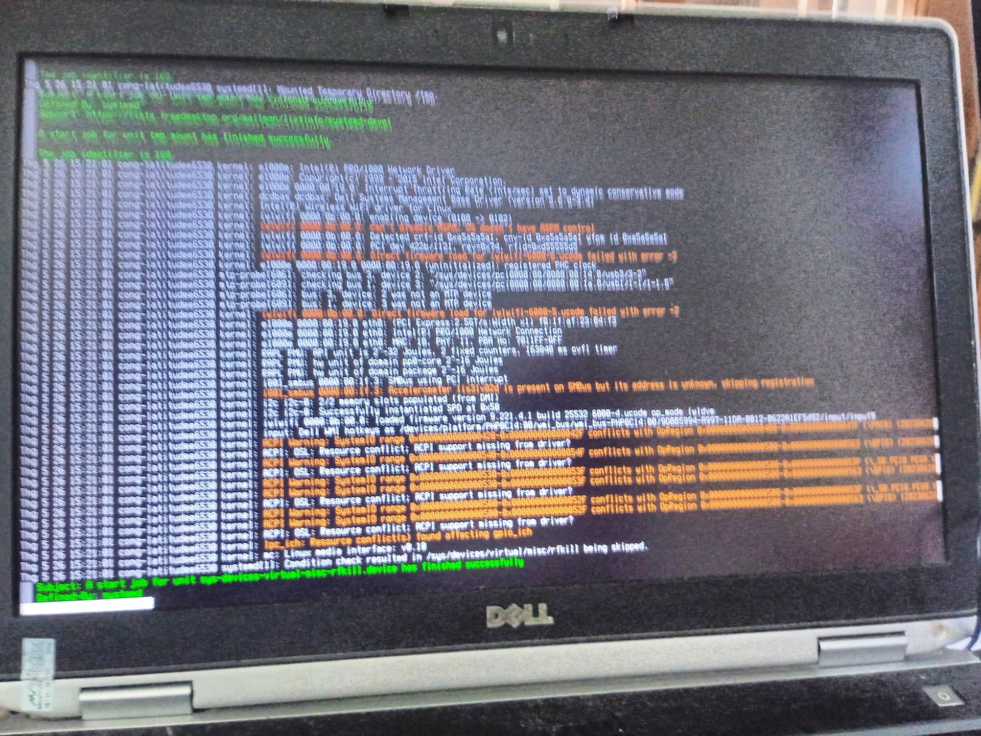

Hello everyone, I have a dual boot system of Garuda Linux and Windows 10. I haven’t used Garuda for a few days, and when I boot into the system, I can’t log in and I’m taken to the Emergency shell. It seems that the system is unable to mount directories including /root.

You are in emergency mode. After logging in, type "journalctl -xb" to view system logs

It’s too late for that, you should have done that in emergency mode when you took the photo. But you can do this again if you are in emergency mode.
inxi cannot read dmi data and when I look at the mount errors and the btrfs error in your photo, it smells strongly of a killed file system…or hardware error.

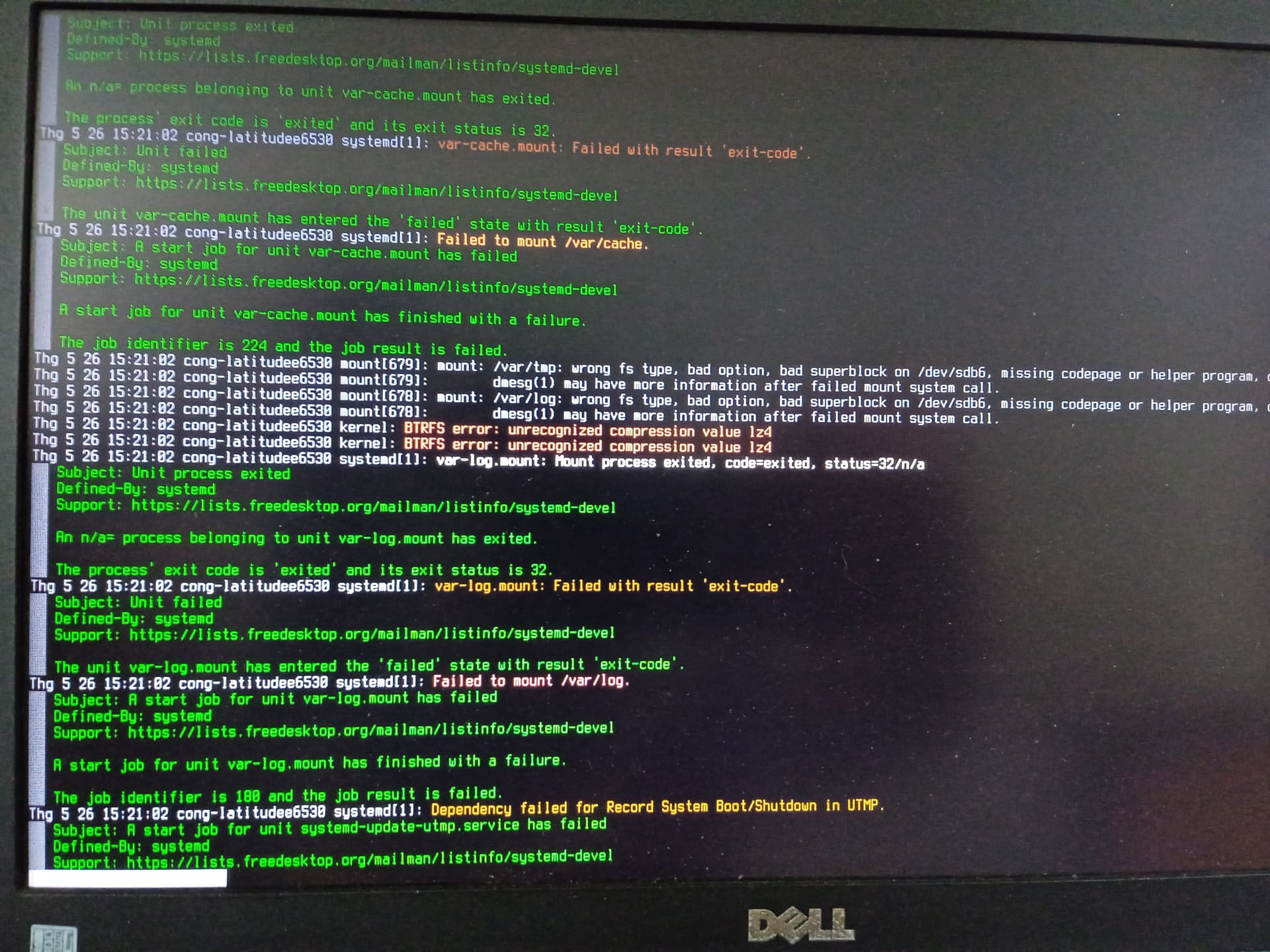

Where is the “unrecognized compression value lz4” error coming from? Did you modify /etc/fstab? The default mount option is compress=zstd.

I have modified the fstab earlier to change the btrfs file system compression algorithm to lz4 from zstd
lz4 is not a supported compression algorithm for Btrfs. Change it back to zstd, or use another supported compression algorithm like lzo or zlib. You can edit /etc/fstab from the live environment and reboot, that should resolve your issue.
