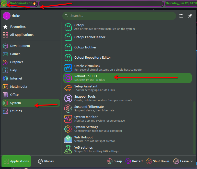

You can also try booting directly from Garuda Linux into the BIOS: Application Launcher → System → Reboot To UEFI.

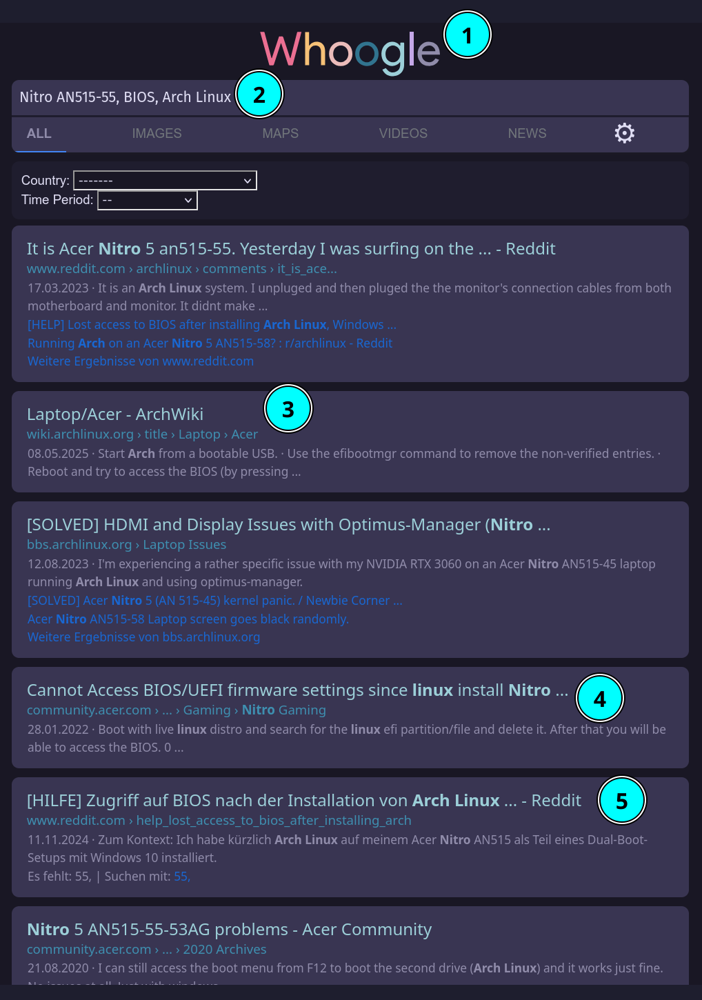

Start using web search, please.
Found one thing from 2020 that went unanswered
