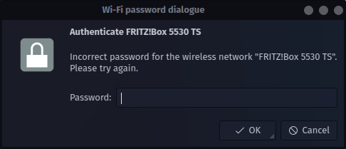

Since a few days my system does not allow me to connect to my home’s WIFI directly. The days before it already had a few problems where it sometimes showed the dialogue in the picture without connecting, but after disconnecting and trying to reconnect it usually did do that successfully after a few attempts.
Interestingly it does connect when I make a WIFI-hotspot on my phone, no matter whether my phone is connected to my home’s wifi-network or currently uses a cellular connection. Home router/whatever is a Fritzbox 5530TS from my local fiber-ISP.

Now it always shows the dialogue in the picture, no matter whether I put in the correct passsword (that also shouldn’t have changed since I haven’t had to reconnect my phone to the network)
First reboot (you never can say).
Then, if you can somehow (mobile tethering, maybe USB?), try the linux-lts kernel.
Check also if you can connect to a 2.5GHz network, if you have or can setup one. Shouldn’t be your issue, anyway:
https://bugzilla.kernel.org/show_bug.cgi?id=218948
Try installing the linux-firmware-git package and then reboot.
You could also try downgrading to an older linux-firmware version, if the linux-firmware-git package doesn’t help, (then reboot).
Try installing the linux-mainline kernel and linux-mainline-headers and then boot into the linux-mainline kernel from the grub advanced boot menu.
Also, try connecting with password authentication disabled. This should only be done for troubleshooting purposes, never leave leave your WiFi’s security features disabled.
You could also try rolling back your system to a date before your problem began.
Please report on the results of my suggestions.
Unfortunately the newer mediatek wifi adapters have their fair share of bugs that require ironing out quite regularly.
Good Luck. :four_leaf_clover:
I am not sure if it can help, but I see you have an older BIOS/UEFI, and a BETA version at that (version 175, 2023-08-04).
https://www.msi.com/Motherboard/PRO-B650-P-WIFI/support
