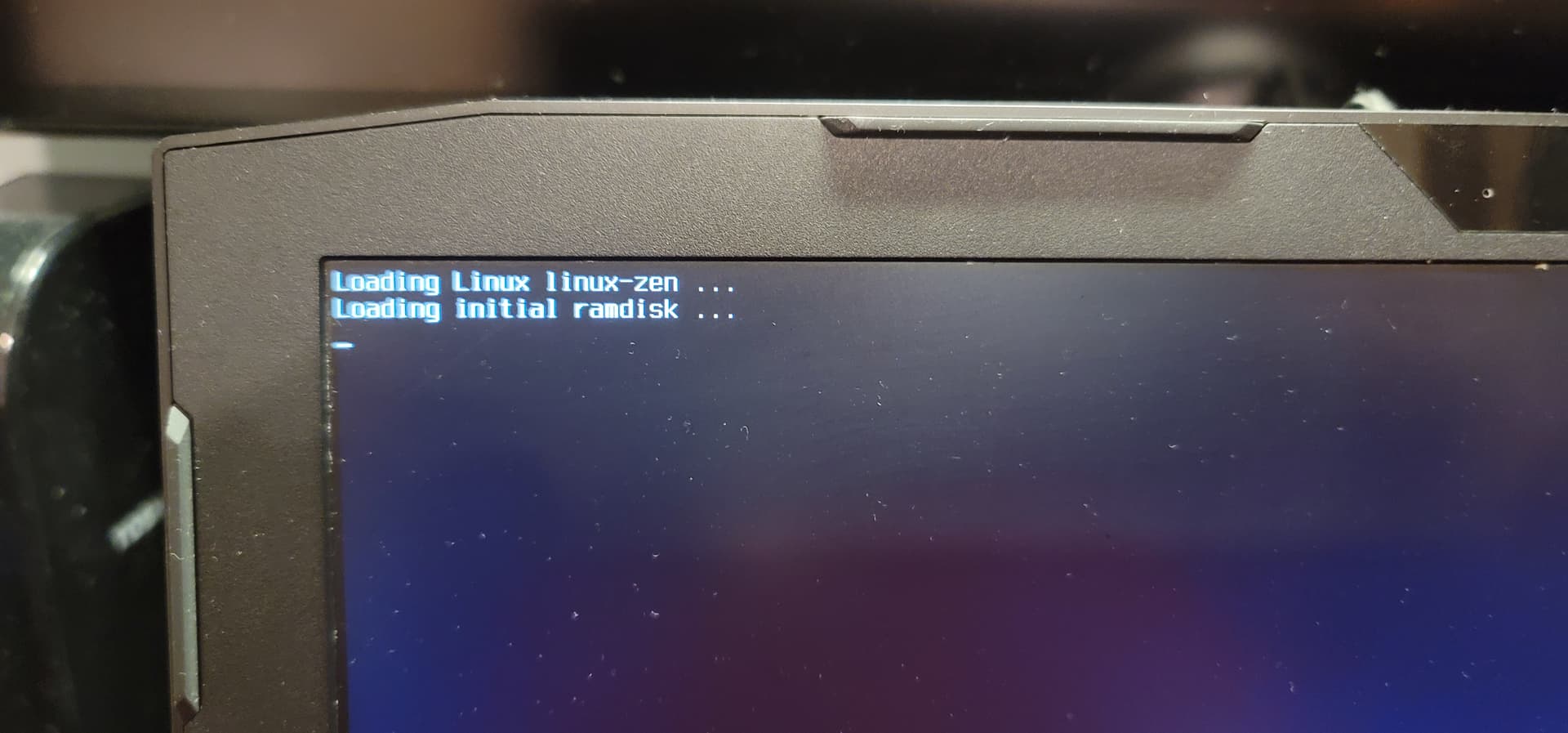

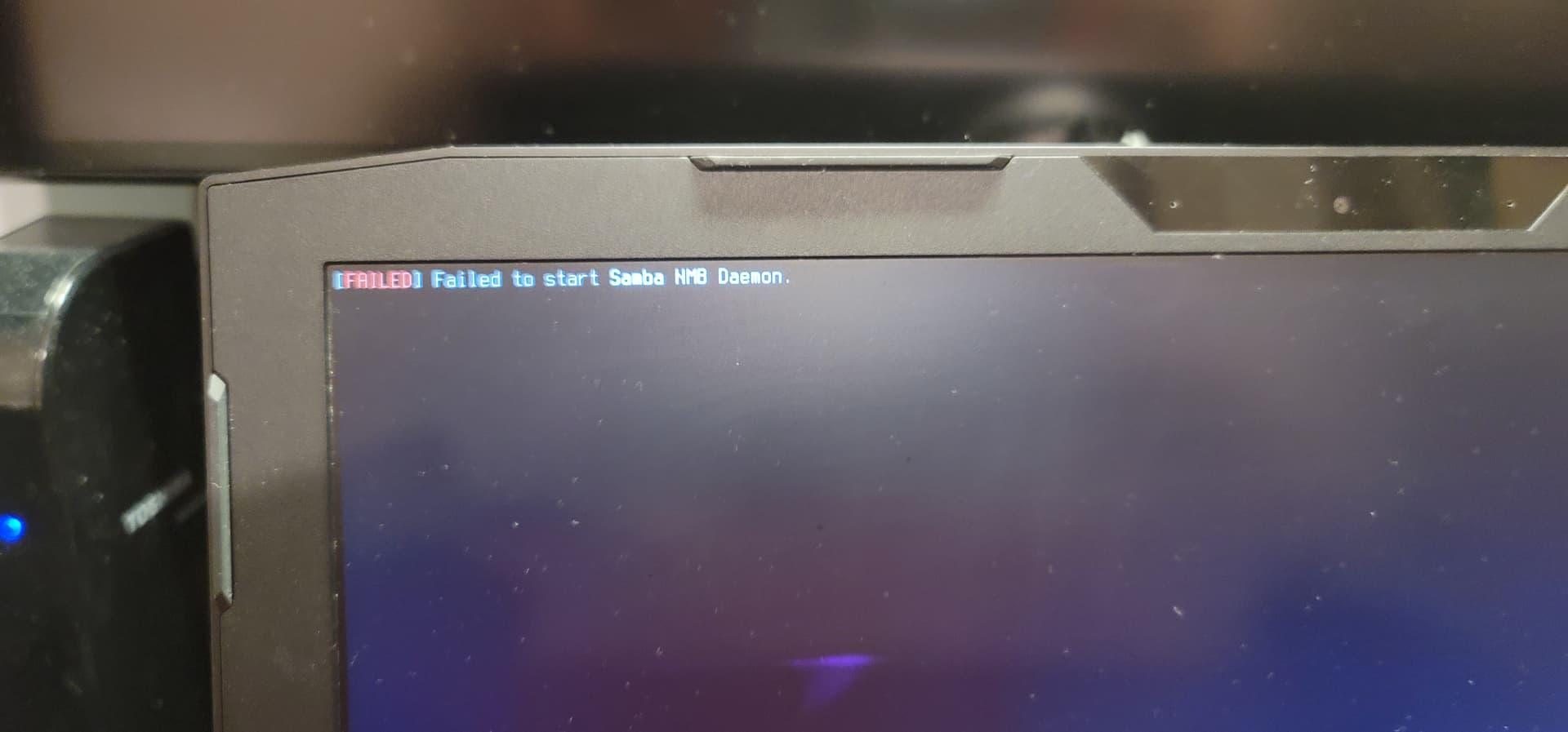

I was able to apply the updates but unfortunately get the error message "Failed to start Displaylink Manager Service" and "Failed to start Samba NMB Daemon"

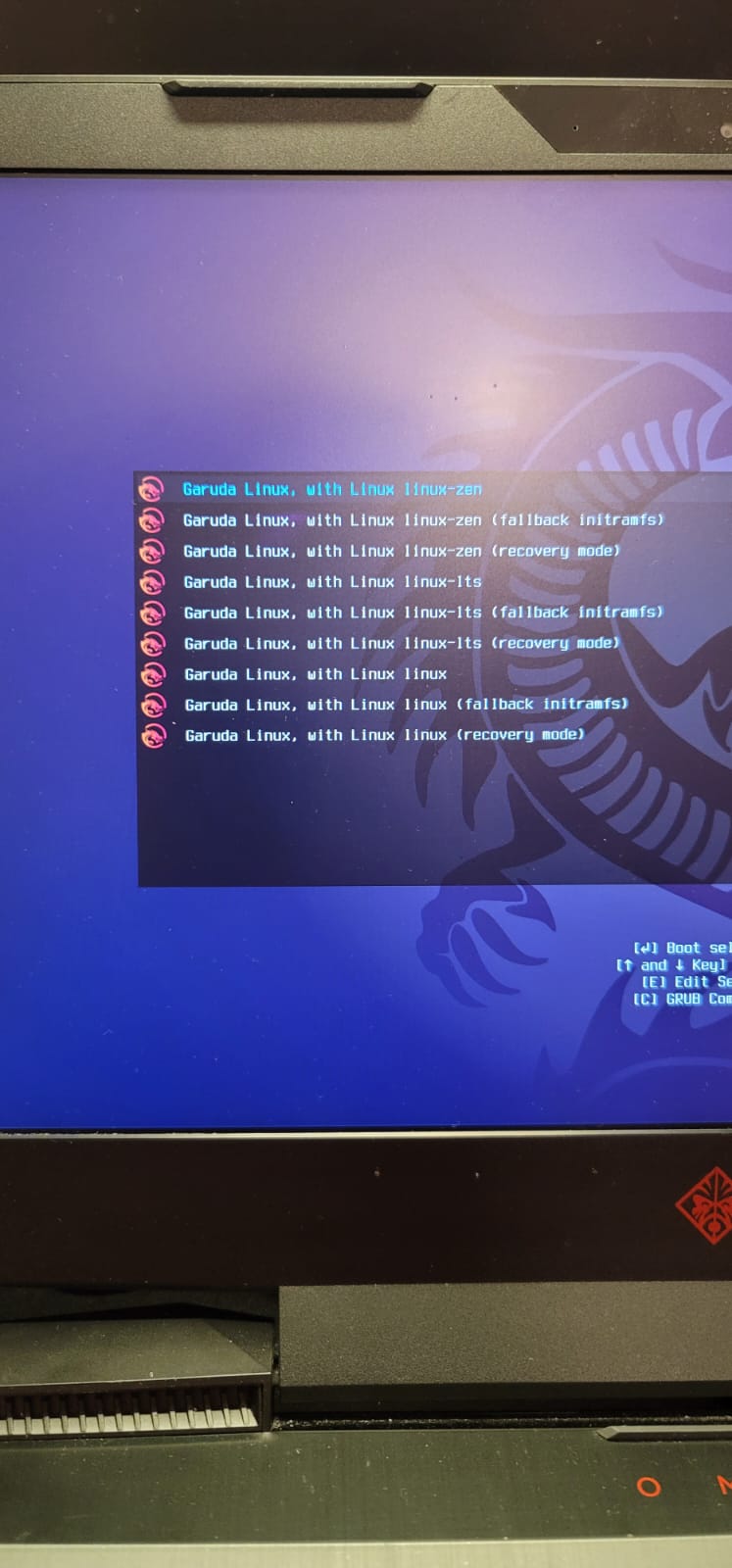

Pay attention to the "1>2" example, which should be the case you need.
Is your linux-lts in row number 5 in the plain list (without submenus I guess) since you used GRUB_DEFAULT=4?

From the image and text analysis, the image is from the 2nd page of grub menu.
If you read again previous advice, you should understand.
1>2 means activate the second choice at the 1st page (menu line numbers start from zero 0, so 1 is second line), which is the Advanced menu options submenu, and on the new page, boot the 3rd line (2 is 3rd line).
Hah OK! Thanks for explaining further. 1>3 now highlights advanced options as default. However, if I let it run, it still boots Zen. Even 1>4 boots Zen. Also did the update command both times as well. So I am very close but still missing one last piece...
