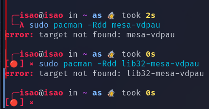

Just 5 minutes ago, I tried to update my system and I got the errors as in the screenshot below:
I tried '“sudo pacman -Rdd mesa-vdpau” but the system says it is not found.
How do I fix this now ?
Please help.

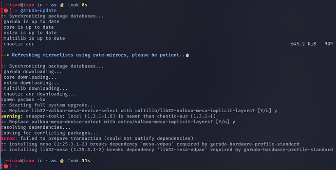

Not op but, I get the same error.
[sudo] password for lii:
garuda is up to date
core                                                         117.4 KiB   289 KiB/s 00:00 [----------------------------------------------------] 100%
extra                                                          8.0 MiB  7.58 MiB/s 00:01 [----------------------------------------------------] 100%
multilib                                                     125.2 KiB   269 KiB/s 00:00 [----------------------------------------------------] 100%
chaotic-aur                                                  645.3 KiB  1353 KiB/s 00:00 [----------------------------------------------------] 100%
garuda downloading...
core downloading...
extra downloading...
multilib downloading...
chaotic-aur downloading...
spawn pacman -Su
:: Replace lib32-vulkan-mesa-device-select with multilib/lib32-vulkan-mesa-implicit-layers? [Y/n] y
warning: snapper-tools: local (1.3.1-1.6) is newer than chaotic-aur (1.3.1-1)
:: Replace vulkan-mesa-device-select with extra/vulkan-mesa-implicit-layers? [Y/n] y
resolving dependencies...
:: installing mesa (1:25.3.1-2) breaks dependency 'mesa-vdpau' required by garuda-hardware-profile-standard
:: installing lib32-mesa (1:25.3.1-2) breaks dependency 'lib32-mesa-vdpau' required by garuda-hardware-profile-standard
Just wait one day for the solution, I think the packages must rebuild.
Yop the garuda-hardware-profile just needs the proper adoption for the Major MESA release :wink:
So far my laptop is having this issue. I have yet to see about my desktop having the same. But I will wait.
No more VDPAU @TNE, but not sure if it should be replaced with vulkan-mesa-implicit-layers or just dropped from depends.
\ garuda-hardware-profiles/PKGBUILD · main · Garuda Linux 🦅 / PKGBUILDs · GitLab
\ 1:25.3.0-2: Enable anti-lag layer (cc8c553b) · Commits · Arch Linux / Packaging / Packages / mesa · GitLab
Went ahead and dropped it. vulkan-mesa-implicit-layers will be pulled in if needed by other packages.

:red_circle:] × sudo update
:: Synchronising package databases…
core is up to date
extra is up to date
→ Refreshing mirrorlists using rate-mirrors, please be patient..:teacup_without_handle:a
garuda downloading…
core downloading…
extra downloading…
spawn pacman -Su
:: Starting full system upgrade…
warning: input-devices-support: local (1.0.7-3) is newer than garuda (1.0.3-1)
warning: networkmanager-support: local (1-9) is newer than garuda (1-7)
warning: printer-support: local (1-9) is newer than garuda (1-6)
warning: samba-support: local (1-8) is newer than garuda (1-7)
resolving dependencies…
looking for conflicting packages…
:: removing vulkan-mesa-device-select breaks dependency ‘vulkan-mesa-device-select’ required by lib32-vulkan-mesa-device-select
Edit: Yes it is, i had an issue with pacman config…….
