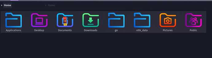

Dolphin seems to have broken transparency/blur after updating the system.
Sometimes it’s opaque and returns to normal after either hovering over with mouse or clicking on the opaque part.

OP is correct I have two Dolphin windows open and when I click on the desktop they should become partially transparent and are not. I also should have more transparency on the docks than I do Now. I switched themes from Garuda’s default cause I noticed apps with the default KDE white.

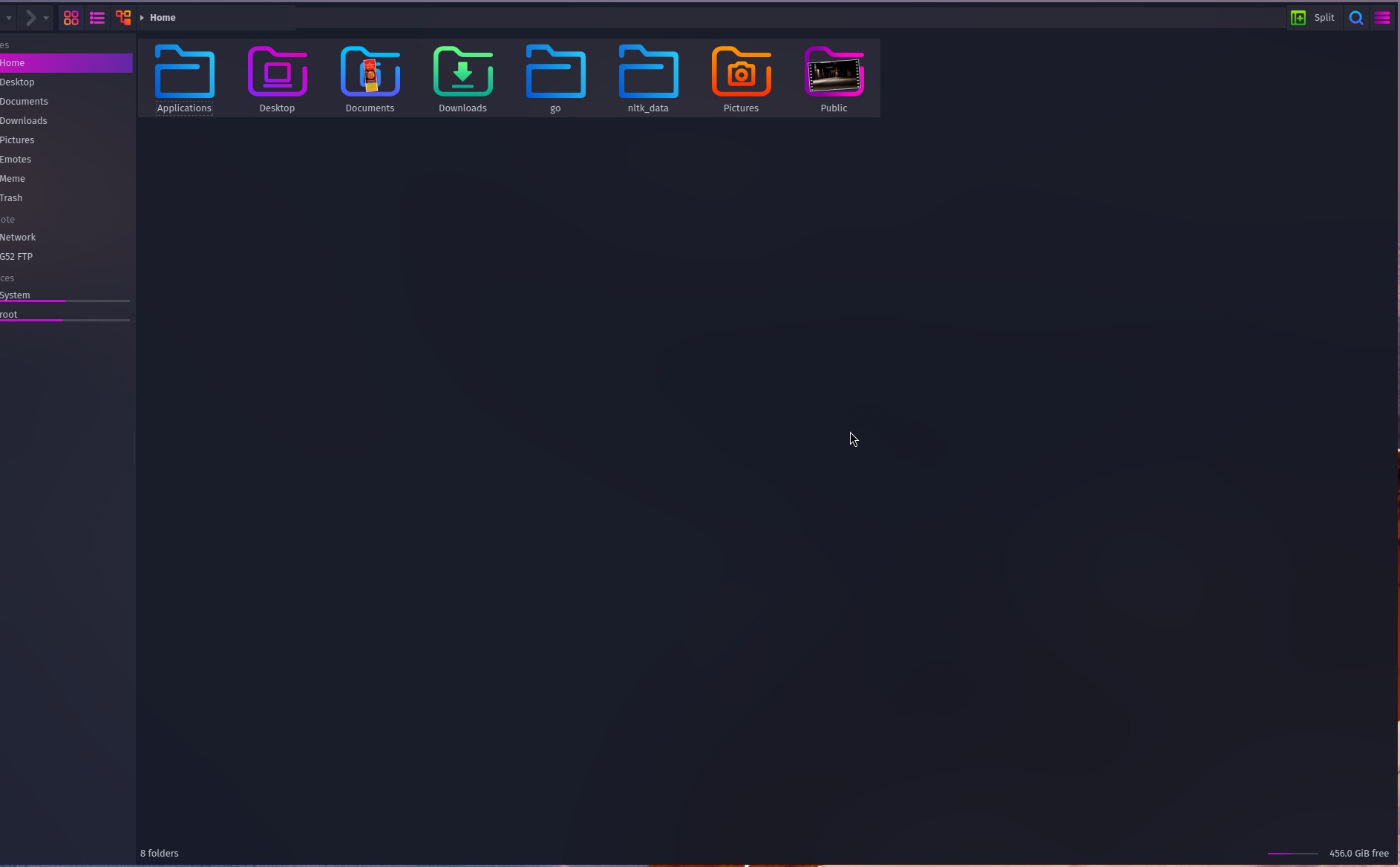

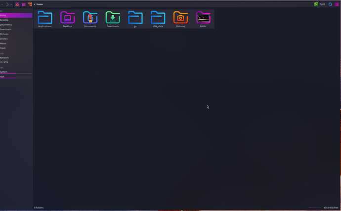

Could you post a better screenshot of Dolphin having the issue? I looked at original one a long time and don’t see what’s wrong with it.

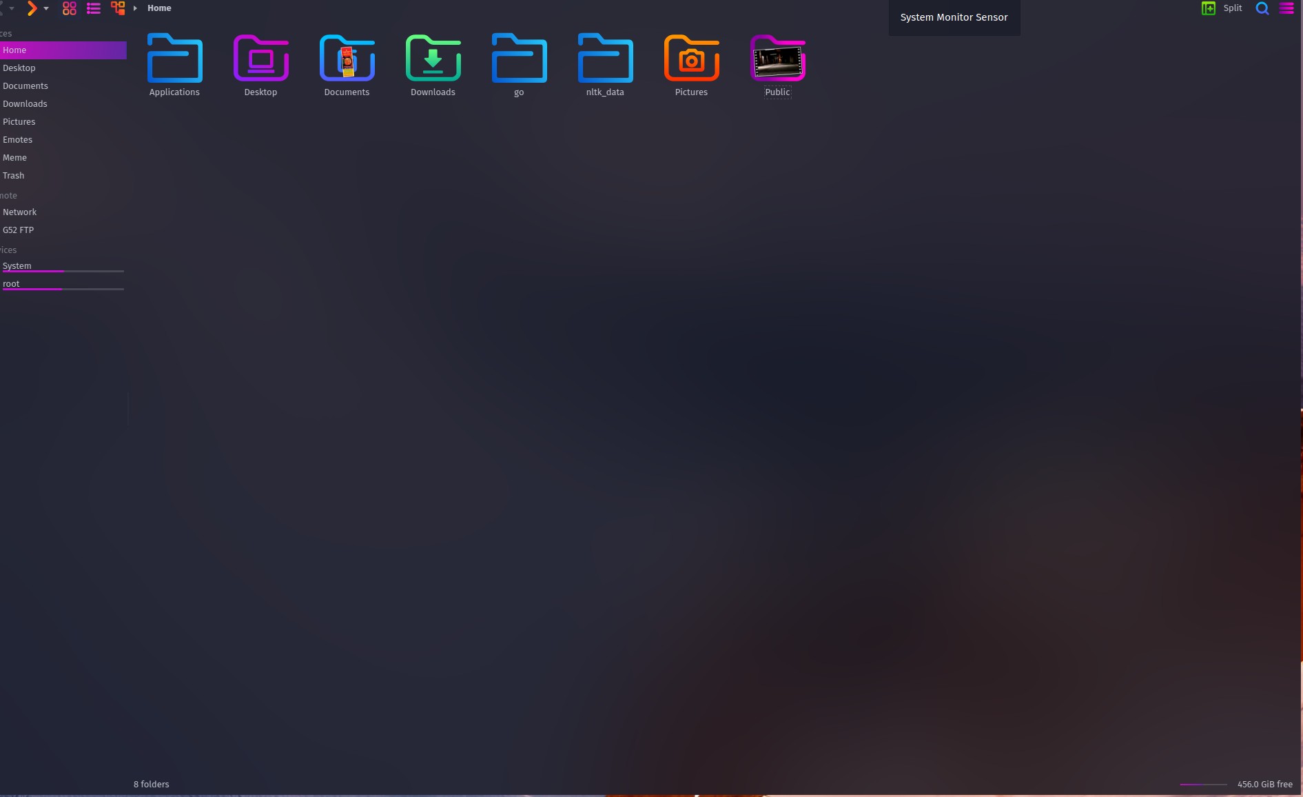

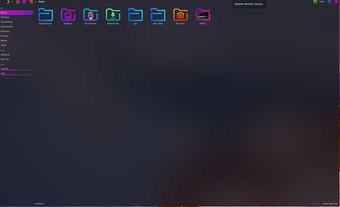

When I open Dolphin:
After taking the screenshot:

I would tend towards a Blur issue, rather than Kvantum. If it were to be the latter the issue would be all the time, the blur would either work or not. In your case you open Dolphin there is no blur and after you hover the mouse it blurs.
Still, do you get the issue with other apps?
I haven’t noticed this issue with any other apps.
Kinda.
Sometimes, it launches normally (with blur working perfectly).
Sometimes, it launches with some parts blurred and I either hover the pointer, to make it blur, or click on certain objects (like the thin margin that separates quick access to from the browser, and the bottom bar that tells free space) to make it blur.
If I take a screenshot, dolphin blurs properly every time. If I minimize and then focus back to it, blurs returns. If I change focus and then return the focus back, it blurs properly.

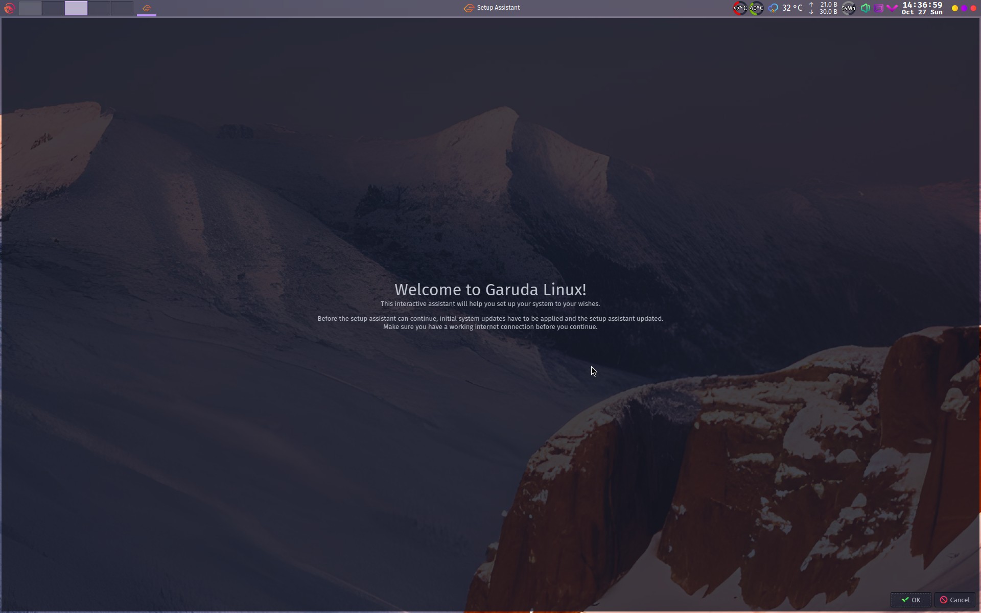

It’s fine in the live CD.

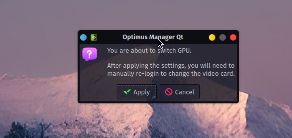

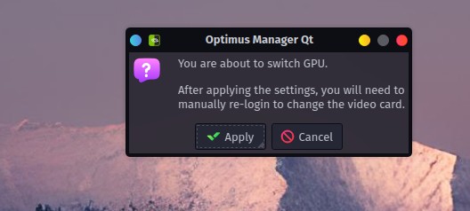

Also the latest update seems to have fixed the issue with dolphin, however, now, dialog boxes seems to have broken blur effect.

That happens sometimes on a Plasma update, certain packages need a rebuild against the new Plasma version and maybe the ISO you tried did not have those rebuilt packages, mostly a timing issue I believe.
Which ISO filename was this?

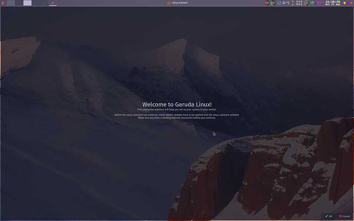

I don’t know if the ISO had no blur. I couldn’t get garuda assistance to open on the live ISO, so I couldn’t confirm. I can confirm that the dolphin’s blur was normal in the ISO. I downloaded the latest one yesterday, garuda-dr460nized-linux-zen-240428.iso
The screenshot I posted of dialog boxes are from my OS. I did not re-install
If you perform a garuda-update the dialog boxes will be fixed, it was a case where some packages needed to be rebuilt after a Plasma update.
