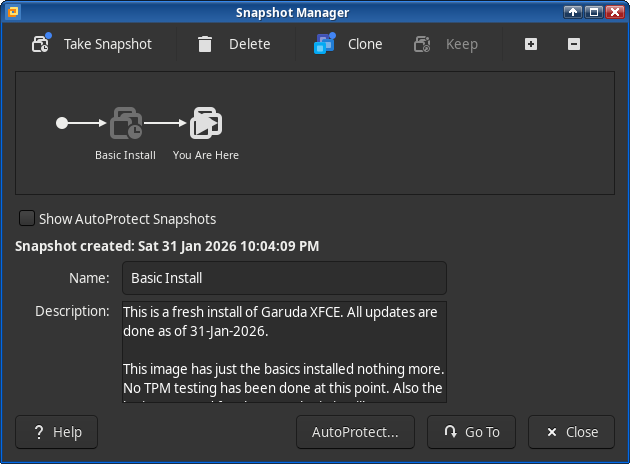

So, to prevent me from blowing everything up, I have built a virtual machine to try and perfect the process and add it to my Joplin notes before I make things so much more worse for myself. And, if somehow it doesn’t work out well for me after following instructions, then I have made an image where I can just simply reset the process again and again and so fourth as you can see here…

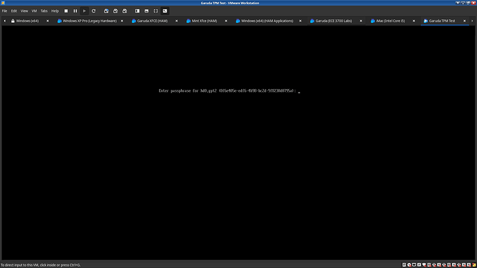

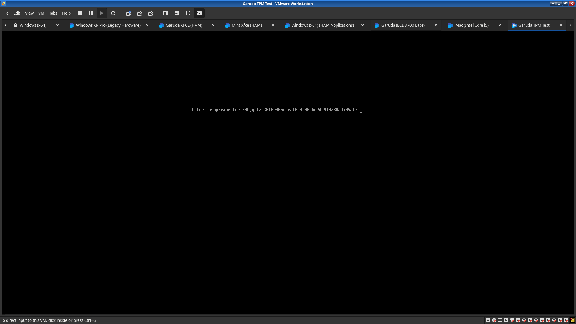

So what I am trying to do is, unlock the system with a password like you normally do when you encrypt Linux. However, I would like it to also use what ever is coming off that TPM to add to the unlocking process.
To make it clear, I’m looking to use --tpm2-with-pin=BOOL so TPM 2.0 keys + a password is used to unlock the drive and continue to load Garuda. What I’m expecting to see is the following in the image below, but also uses TPM 2.0 keys…
Does anyone know how to properly do this in Garuda or could please guide me through the process?
