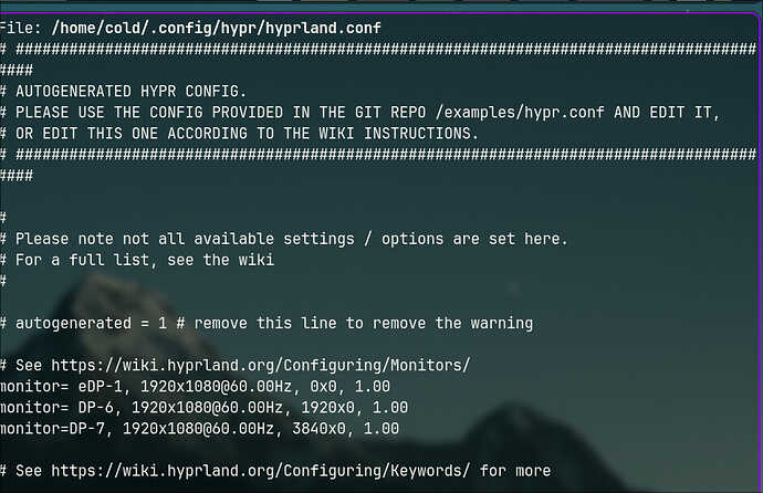

Hello!
i want to set up three monitors in my Garuda Hyprland SO.
I have problems configuration the third monitor.
I dont know what i am doing badly.

Check your settings with arandr.
You can save the data and use them in the hyprland.conf .
Try to post the full garuda-inxi output, next time.

Thanks for the reply! Here you have:
 [email protected] at 0x0

Hmm… AFAIK it should work .
The same issue is being faced by another user here :
maybe you give a shot to nwg-display :
sudo pacman -S nwg-displays
we also have wdisplay installed you can try to configure from that too
I am so happy m8 :slight_smile: .
i unistall wdisplay and install nwg-displays and works!!!
Than you like always i love you!
