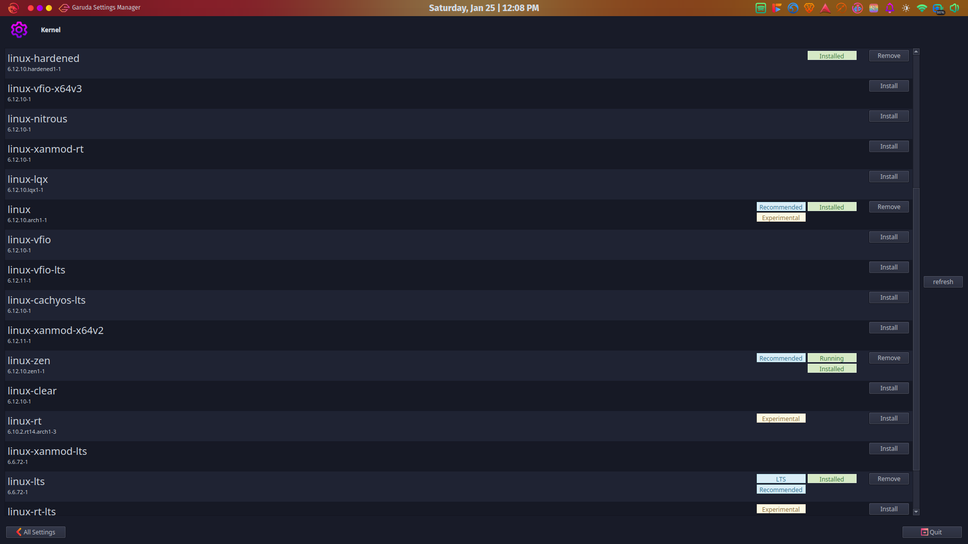

This is what's messing my updates up
Ihat one missing module is causing alot of problems but I can’t seem to get it back even if I try to install it manually x_x I had to btrfs snap back to wednesday on my system and when I updated again everything froze on discreet with my HDMI port not working so then I snapped back again and narrowed down this as a potential reason why my updates are messing up my system ): I guess you could call this a follow up to my last topic regarding the brightness which yesterday seemed to had worked itself out but then after updating everything got weird again.
I did ask my friend about it who’s been on Linux longer than I have and they recommended me to reinstall x-x
> find: ‘/usr/lib/modules/6.8.7-zen1-2-zen/’: No such file or directory
> nvidia/565.77, 6.12.10-arch1-1, x86_64: installed
> nvidia/565.77, 6.12.10-zen1-1-zen, x86_64: installed
> nvidia/565.77, 6.12.9-hardened1-1-hardened, x86_64: installed
> nvidia/565.77, 6.6.72-1-lts, x86_64: installed
> nvidia/565.77, 6.8.7-zen1-2-zen, x86_64: installedfind: ‘/usr/lib/modules/6.8.7-zen1-2-zen/’: No such file or directory
> (Built modules are missing in the kernel modules folder)

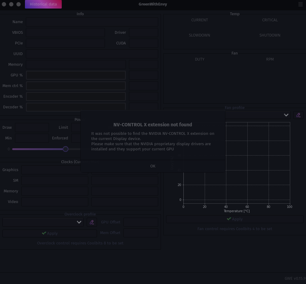

--> A problem with the NVIDIA drivers has been detected
---> Building NVIDIA DKMS module for kernel 6.12.10-arch1-1
Module nvidia/565.77 is not installed for kernel 6.12.10-arch1-1 (x86_64). Skipping...
Module nvidia/565.77 is not built for kernel 6.12.10-arch1-1 (x86_64). Skipping...

These were all my updates since I had to jump back to wednesday

I wonder if this green with envy program has to do with anything. As far as I know I have nvidia but according to that program I don’t
Because you are in hybrid mode and your AMD iGPU is active.

wow I can’t seem to get the picture I took of my screen with my phone because it’s too big and when I resize it, it goes to a solid color which is weird o-o
I know.
You get the error message in GWE because the AMD iGPU is currently active, and not the nvidia dGPU.

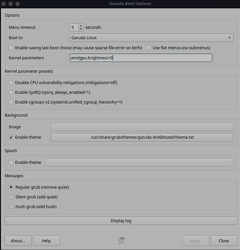

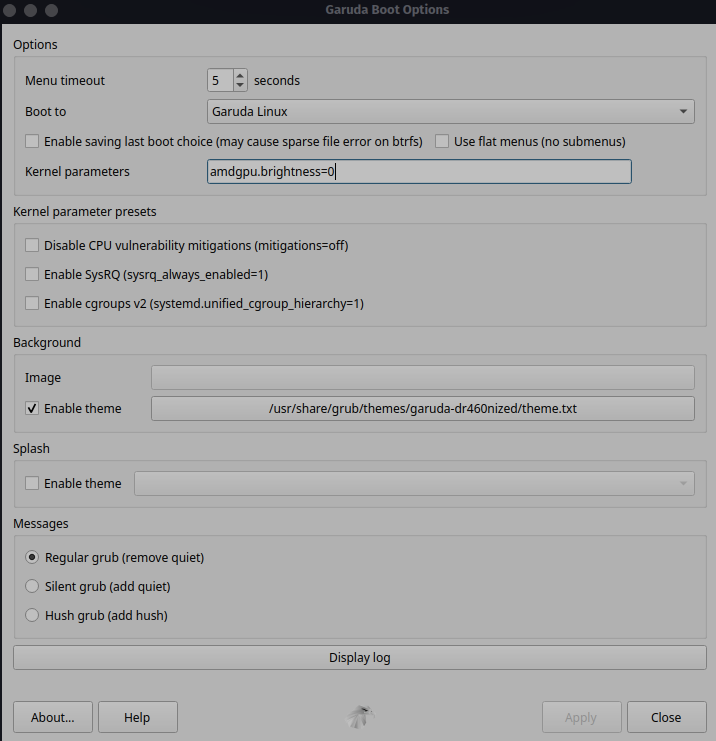

sorry for being a nuisance, how do I delete the brightnessctl set 50%??? Perhaps that could be the issue on it’s own but I will also reinstall the nvidia drivers
GRUB boot loader configuration
GRUB_DEFAULT="0"
GRUB_TIMEOUT=5
GRUB_DISTRIBUTOR='Garuda'
GRUB_CMDLINE_LINUX_DEFAULT="amdgpu.brightness=0"
GRUB_CMDLINE_LINUX=""

What do you do? Just use “Garuda Boot Options” - you’ve done that several times already, remember?
I used Garuda Boot Options and posted the screenshot but for some reason it keeps showing the brightnessctl 50% and I restarted and it still is giving that inxi

I get that same error, I think it just needs an extension installed for it to work. Never used that program.
