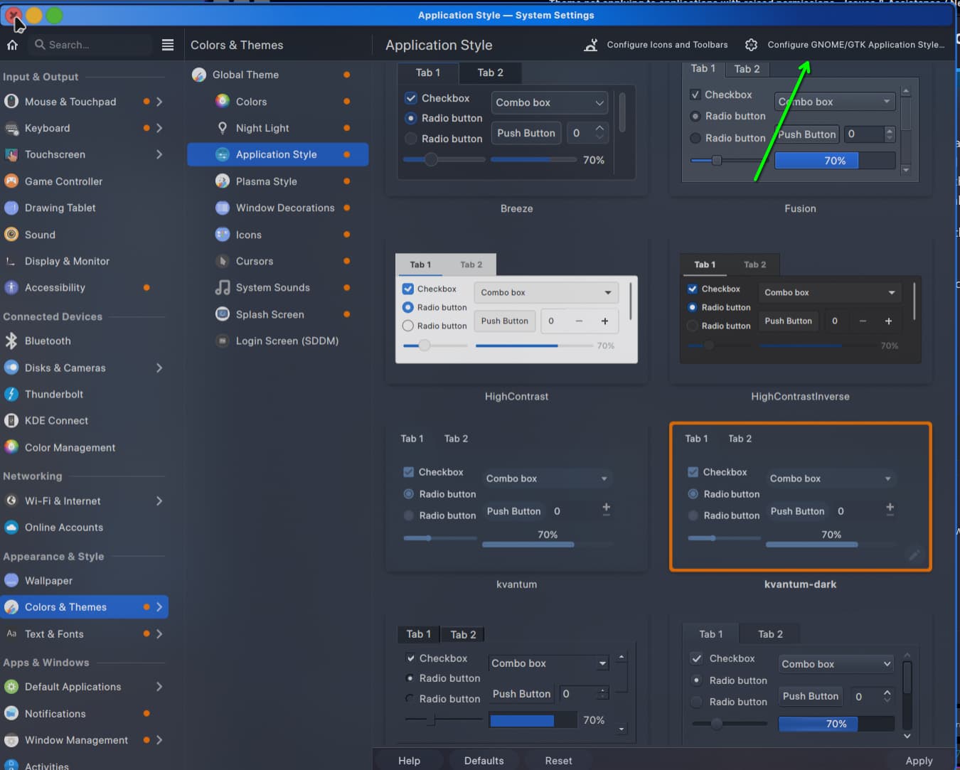

go here, an find a theme thats is yours or close to it. Dont forget to test it since some of them are broken due to gnome being gnome.
@dalto has posted a simple method in the past for standardizing user and root colors/themes:
