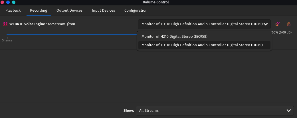

hi, thanks for the support but I didnt quite understood, so when I join a voice channel in discord and open pavucontrol at the recording tab, all that I see is this:
And i actually notice something, when I’m with Monitor of TU116… I cant even hear the echoes, but when I’m with monitor of H210 i hear them, if you want me to full screenshot pavucontrol in all options, I can do it (for an example: screenshot when i’m at playback, output, etc)
UPDATE: Actually it worked, I checked the pavucontrol and found my mic at the input, I dont really know what i did but it worked, thx for the support and for your time
