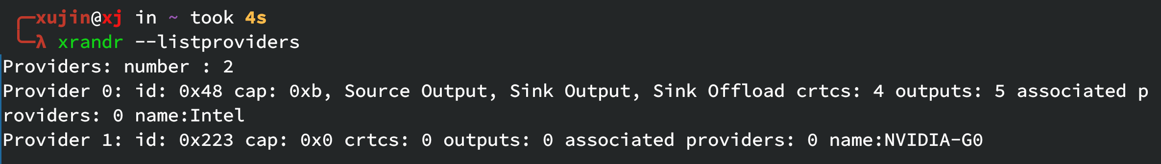

Hello friends,i recently installed the latest version of Garuda Linux,and installed a private graphics driver, but there is a problem. Need help !!!!
When run "nvidia-settings", get the error: NVIDIA driver is not loaded
"NVIDIA X Server Settings" also fails to startup

You have to start it with
prime-run nvidia-settings
Check your bios
And see if it has gpu switching options
Try changing them
The check
XuJinNet:
driver: N/A
Hmm it looks odd
Have you upgraded your system ?
If not upgrade your system first
sudo pacman -Syyuu
Yes, I have upgraded the system to the latest before install the NVIDIA Driver.
And i checked the bios, There is no switch for GPU.
Do i need to try this?
Check logs
journalctl -b -p3 --no-pager --no-hostname
bash -c 'for Xlog in $(ls /var/log/Xorg.?.log); do echo -e "\n" $Xlog ; grep -E "(EE)|(WW)|failed|Time" $Xlog ; done'
Also post this file's contents to bin.garudalinux.org
/var/log/Xorg.0.log
Could you try:
sudo modprobe -v nvidia
and paste the output (as text!).

The file`s contents:
/var/log/Xorg.0.log
Evidence is the same as other issues where BIOS is auto hiding dGPU from the system.
I suggest you ask this at your Laptop’s vendor Support forum.
How can I disable “auto-enable/disable dGPU”?

@jonathon Thank you very much! The Nvidia Settings can be opend, How to verify that the Nvidia graphics card can work normally, please ? @jonathon @petsam @librewish
Please, don’t post images for just text output. It is explained numerous times.
Manually, start apps with prime-run <app>
Else, the system would automatically use nvidia for resource hungry apps.
