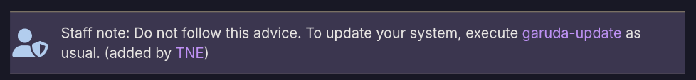

That feeling wasn’t as long as it was. You just need to run uname -r.
sudo dracut /boot/initramfs-$(uname-r).img $(uname -r) --force
sudo grub-mkconfig -o /boot/grub.cfg
Just to be safe, double-check using sudo pacman -Syu
If no warnings or other issues appear, it’s safe.

I don’t know why you would recommend this! There is no need to run this command. You should recommend sudo dracut-rebuild instead, for future notice. Dracut should almost never be run manually without the script. (since any parameters you pass will be invalidated during the next system update.)
This should not be done either!
Do sudo update-grub instead!
Do garuda-update instead!
There is no need to run any of these commands manually!
