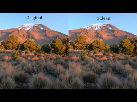

btw for those who were asking about denoising comparison, I just released a video showing denoising comparison
What does the denoising process do? Is the difference supposed to be visually obvious?
On my monitor the before and after look exactly the same, although I also have an untrained eye.
There's considerable noise in the grass, it's supposed to remove that grainy noise without losing details, and without making it look like plastic or distorted. Also a lot of the noise is temporal, so it's not just comparing static frames, but also have to see how it looks in motion. The difference in the last Webcam video is really obvious. As for the water & cliff video, the difference is very subtle; but the point is that it doesn't deteriorate the image. The problem I had with that video is that one part is dark and extremely noisy, so I need to process the clip; but didn't want it to degrade the rest.
Also keep in mind; you're looking at a 5K clip on a 1K display properly. It's VERY HARD to remove spacial noise, and particularly large-radius noise, on a 5K clip. Especially without losing fine details. I struggled a lot with large-radius noise such as the car dashboard. Also the video got encoded twice after processing, losing some details such as noise. You'll get a more accurate image if you select 4K quality in YouTube.
It combines motion-analysis with spacial analysis and temporal analysis.
