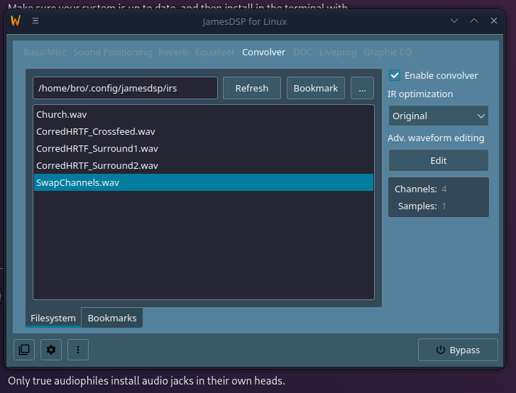

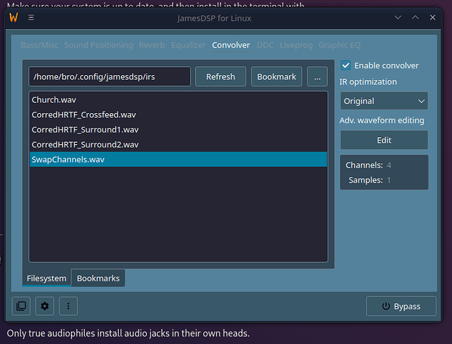

Try JamesDSP. It has channel-switching plugins. And much easier than EasyEffects. :smiley:
Ya, I keep forgetting about JamesDSP :sweat_smile:. I think its because it had some nasty bugs quite some time ago and I keep forgetting to give it a shot again.
