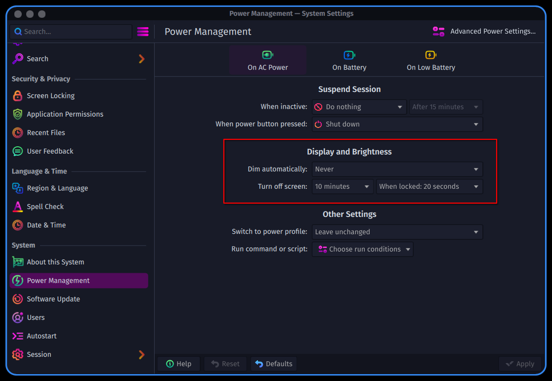

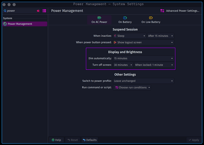

Hi Locutus,
Do these settings work?
That works. Thanks

I have similar settings, (OLED screen, so preventing burn-in). As for the button on the taskbar, I have a Logitech MX Keys S keyboard, I press the lock key on the upper right corner and the screen turns off in 20 sec.
Note, when I wait 10 minutes, a key press or mouse movement brings the display backup without a password. Pressing the lock, a key press or mouse movement requires a password.

Just set it to turn off screen 20 or 30 seconds when locked like @ARClite showed and press super + L whenever you want to activate the lock screen. Or change that shortcut to whatever you like…

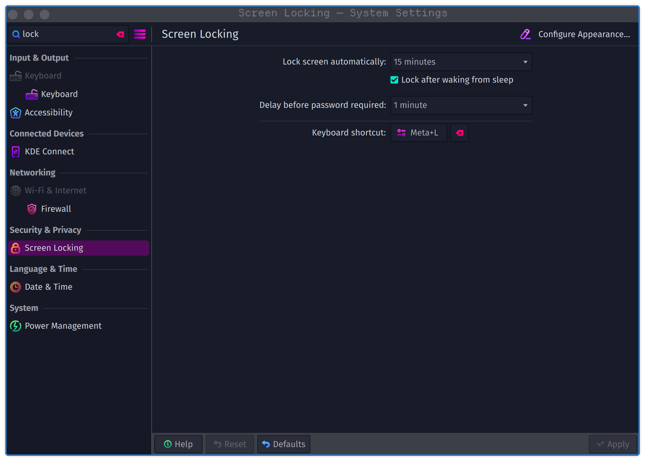

Edit: I see what the problem is:
You can disable the lock screen completely here (at your own risk :melting_face:):

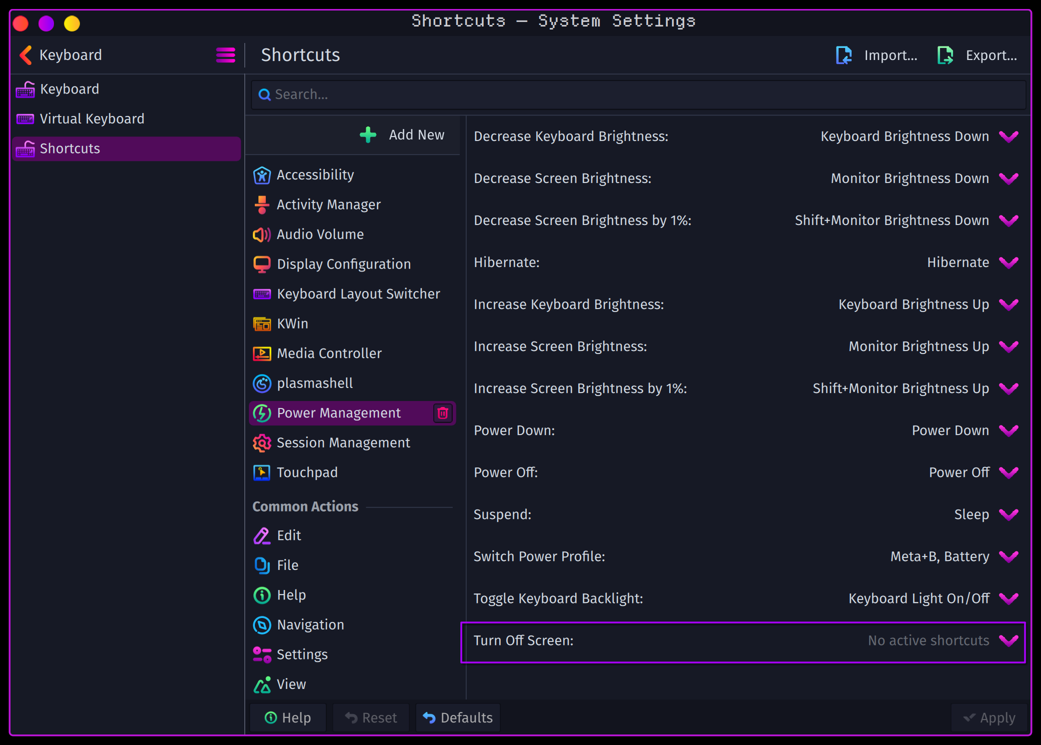

Then add the shortcut to turn off screen here:
KDE can do anything, just gotta dig a little :wink:
