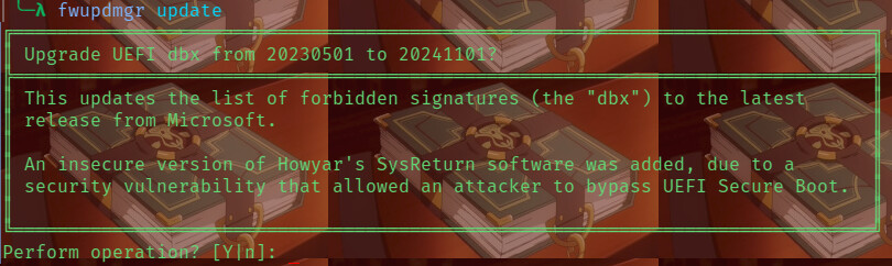

Please do not post pictures of the terminal. Always use a code block for terminal output. Thanks. :slight_smile:
I advise you not to do this.

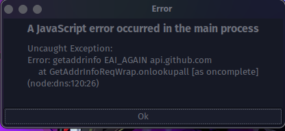

This is just a javascript error message. As far as I know Node.js has no DNS caching, so everything DNS related ends up in the OS. I don’t know which application this comes from, spotify, docker or whatever, but this is a network error and has nothing to do with your HDMi issue.
Sudo is not needed and resetting pacman.conf and refreshing the keyrings is not helpful with the error message “exists in filesystem”:
