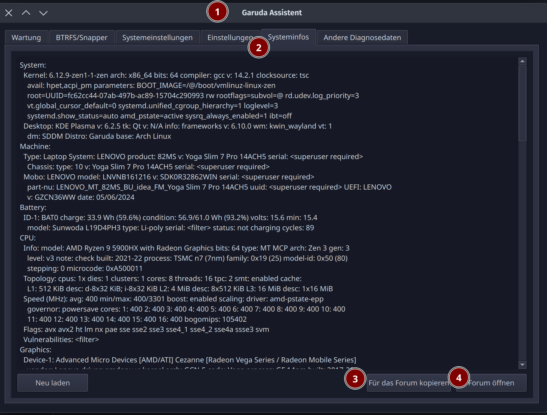

Is there a way to “obscure” my username in the starship bug report before forwarding it to Github?
You can use garuda-assistant

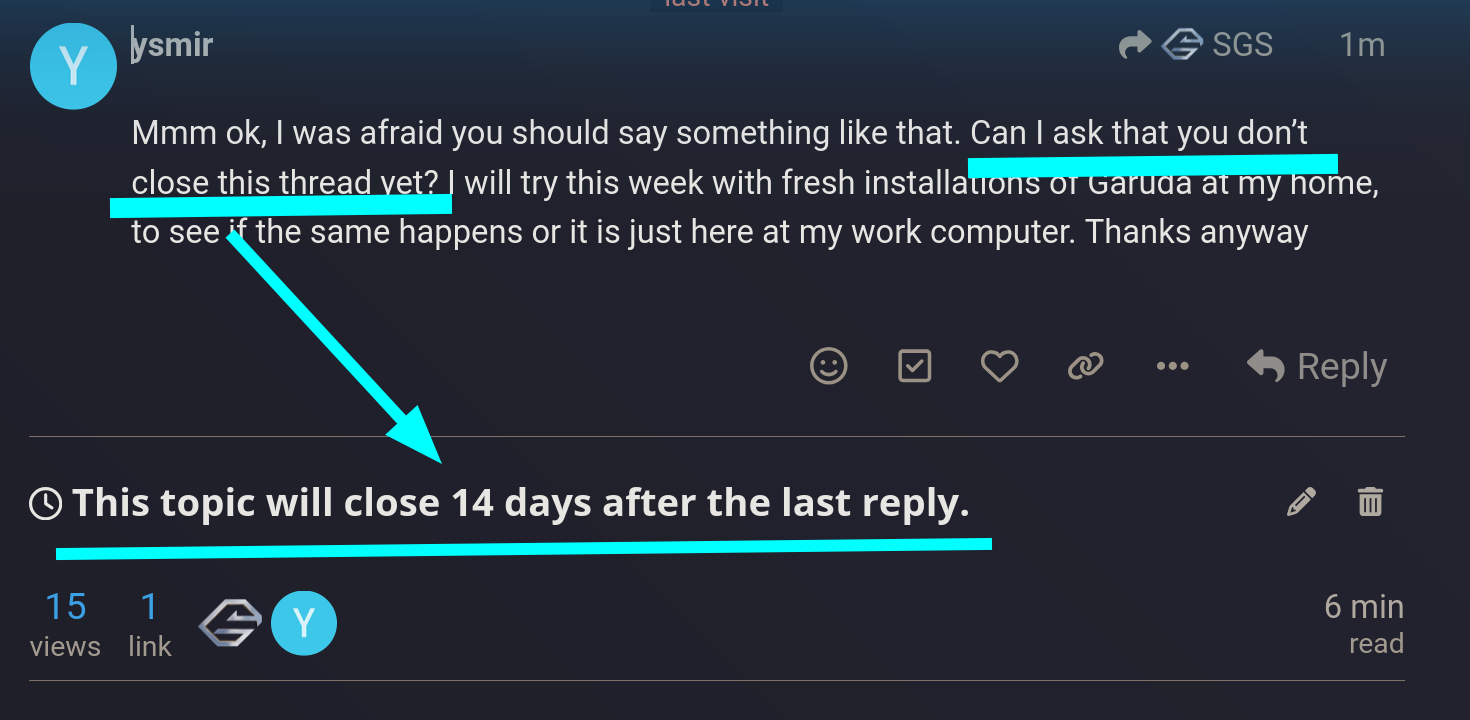

Mmm ok, I was afraid you should say something like that. Can I ask that you don’t close this thread yet? I will try this week with fresh installations of Garuda at my home, to see if the same happens or it is just here at my work computer. Thanks anyway
Just test it in a VM, that saves you a new installation on bare metal :wink:
