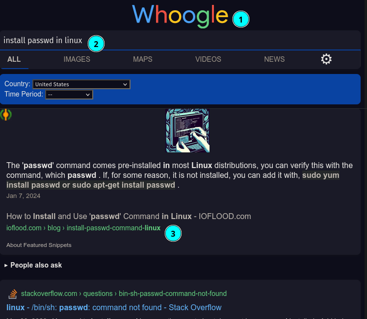

I’ve merged but now I’m getting the message “sudo: you do not exist in the passwd database”. Is there a way to fix this other than using a snapshot? Google didn’t help me.
