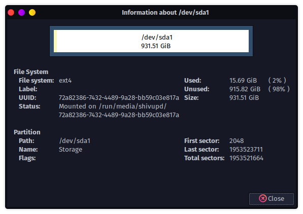

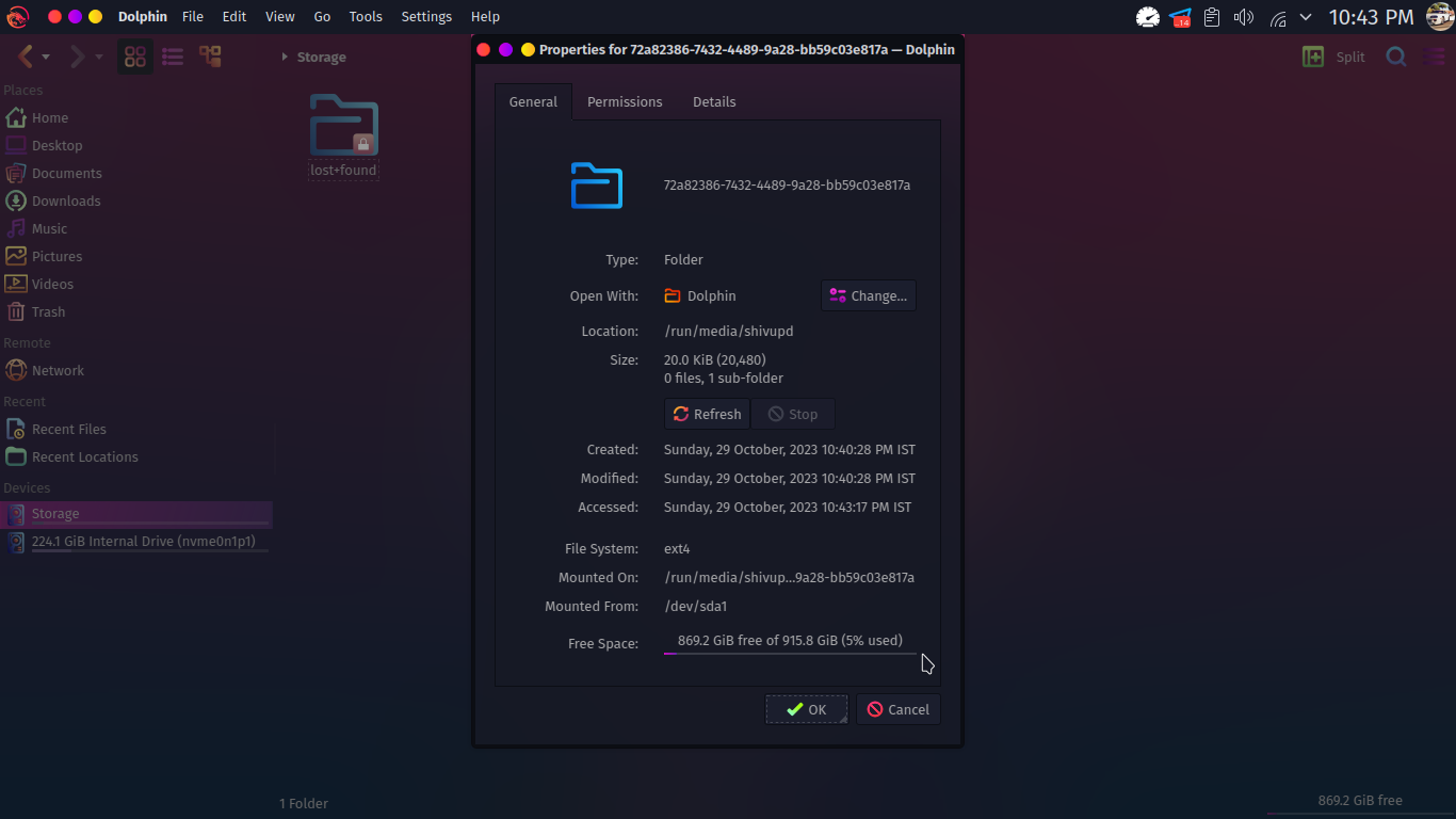

I am facing an issue regarding my storage drive, which is used by some unknown factor. Total 46 GB of data is being used but I don’t know what it is being used for, first I thought it might be the steam game I have installed but then I checked and it wasn’t the game. I have formatted the storage more than two times, but no result. Can you please identify what it’s being used for? or how can I get that storage back? screenshots are attached, Thank you.

So as BluishHumility asked, this is the df -h output:
Filesystem      Size  Used Avail Use% Mounted on
/dev/nvme0n1p1  225G   39G  185G  18% /
devtmpfs        4.0M     0  4.0M   0% /dev
tmpfs           3.9G   40M  3.8G   2% /dev/shm
tmpfs           1.6G  1.6M  1.6G   1% /run
/dev/nvme0n1p1  225G   39G  185G  18% /home
/dev/nvme0n1p1  225G   39G  185G  18% /root
/dev/nvme0n1p1  225G   39G  185G  18% /srv
/dev/nvme0n1p1  225G   39G  185G  18% /var/cache
/dev/nvme0n1p1  225G   39G  185G  18% /var/tmp
/dev/nvme0n1p1  225G   39G  185G  18% /var/log
tmpfs           3.9G   14M  3.9G   1% /tmp
tmpfs           782M   80K  782M   1% /run/user/1000
/dev/sda1       916G  2.1M  870G   1% /run/media/shivupd/72a82386-7432-4489-9a28-bb59c03e817a

The 16GiB you are “missing” is in use by ext4 itself, for filesystem metadata. Take a look at this thread if you would like to learn more about that:

Shredded the hdd, took 11 hours 56 min, still 46 gb pre occupied… I give up for now. After shredding it was 931 gb. But as soon as I format the hdd to ext4 it is eating up that space.
it was explained earlier in the thread, it’s file system metadata and no matter what you do it will ALWAYS be there taking up some space.
i have a 111GB available out out of 120 on my smaller SSD’s due to file system metadata.
I know. Certain amount of space is always preserved, you buy a 128 gigs SD card you get 123 gb or so but 46 GB is massive. Something must be reserved there.
You keep saying 46 GB but I am not seeing where you are getting that from.
In the screenshot you have shared it looks like 16 GB is in use:
This is less than 2% of the disk, and aligns with typical metadata size for ext4.
