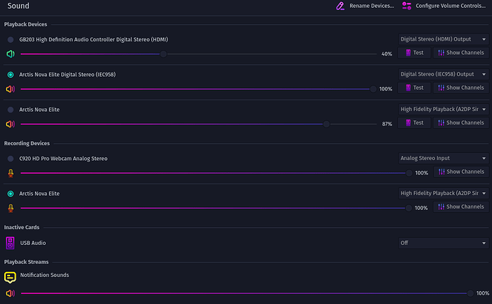

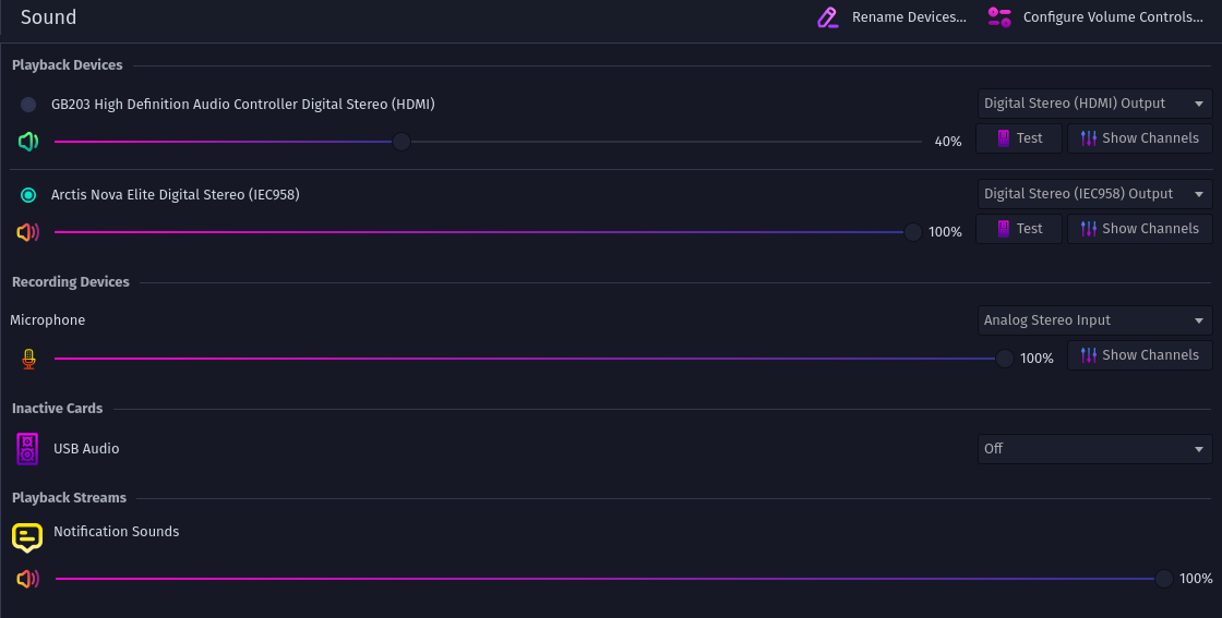

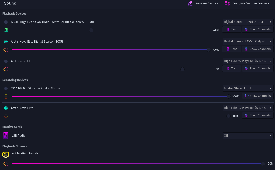

As the title says my Arctis Nova Elite USB headset is showing the output module just fine, but the input does not show up. Rebooting and updating does nothing. When I go to the audio menu, I see just my webcam and nothing else as an input. Connecting the headset via Bluetooth the microphone shows up fine, but I would rather use the USB base station for wireless and not Bluetooth.
With Bluetooth off:
