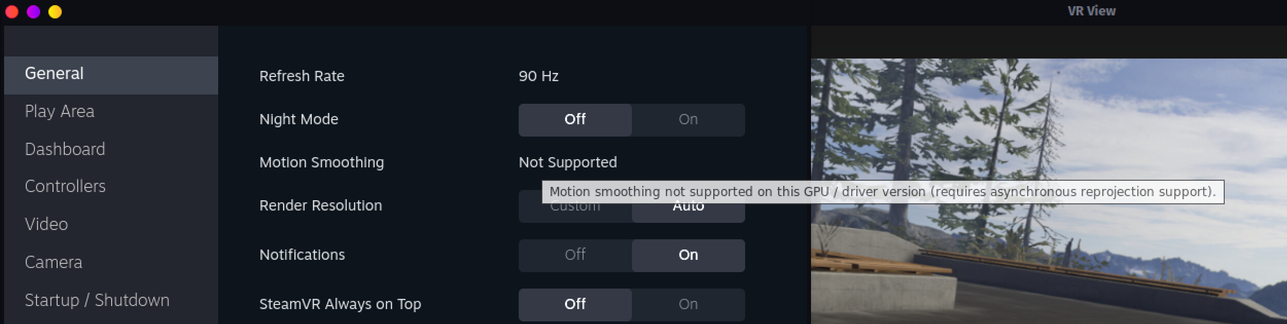

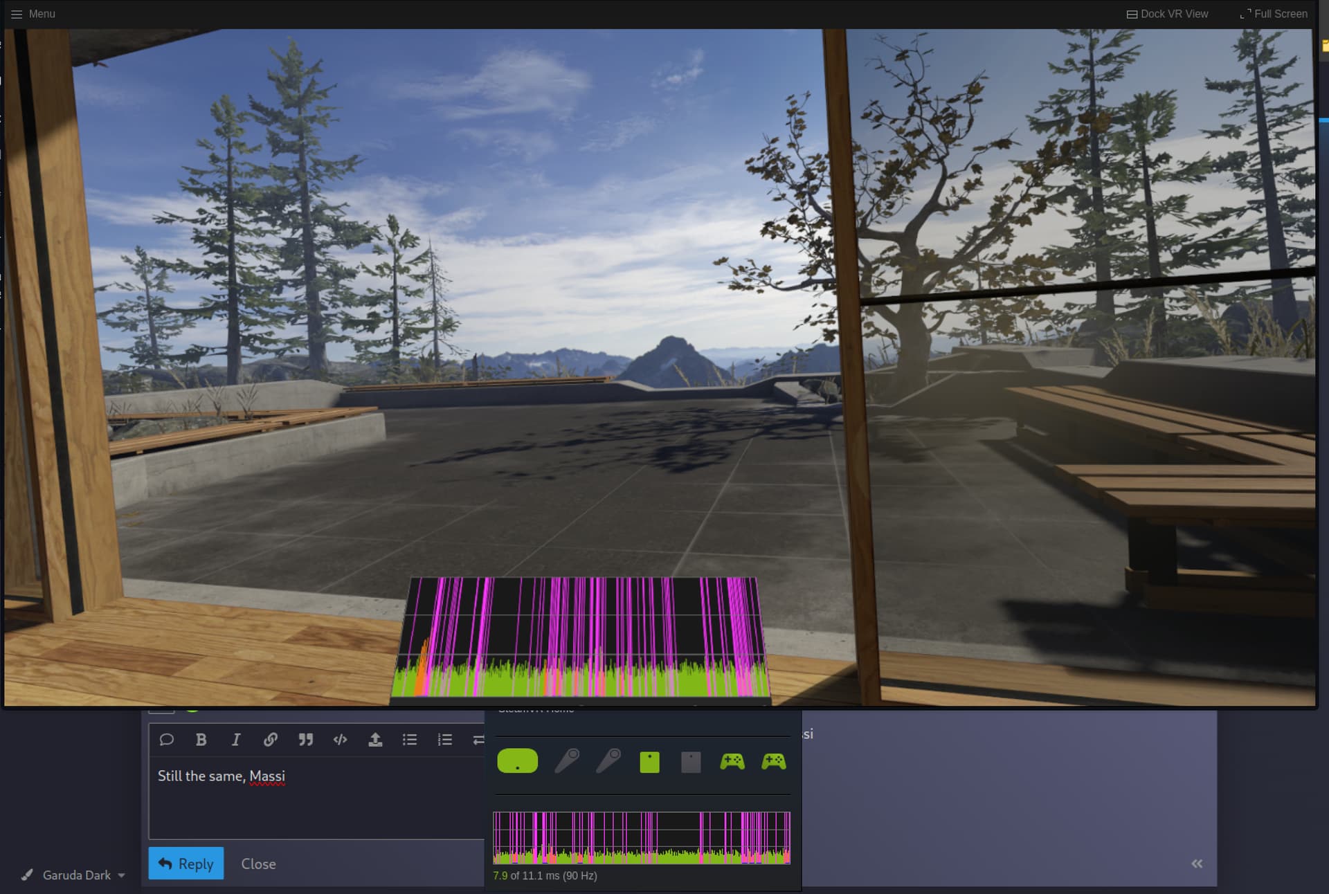

On Windows I have no issues at all, however on Linux it is unplayable. From the Start in SteamVR Home there is massive stutter at all times, which is visible on Performace Graph. I would post a screenshot however I am a new user so I am unable to.

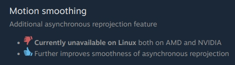

I also noticed, that “Motion Smoothing is not supported on this GPU / driver version (requires asynchronous reprojection support)”.
I was under the impression it was added in recent NVIDIA driver, but I am unsure if this is not supported on Linux yet, but it may be the reason I have issues?

I should have mentioned, yes I have tried on both and the issue is the same on X11

Still the same, I should be able to post picture of the performance bar now:
I also see this in the settings, don’t know if this is related, I mentioned it in original post:
have you tried in x11 and wayland? is there a difference?
I have tried it on both, yes, both have the same issue, not sure why, as I am running on the latest drivers provided by Garuda (which I assume are the latest proprietary drivers), and now the latest BIOS as well
I wish I could help you more and test further. But I do not have an VR headset and I am running AMD hardware.
Steam guide I found says:
I would suggest to further check this extensive guide:
Thanks, I tried that guide before coming here, as I wanted to go over all possible solutions before asking here.
I may try and ask on Steam forums or somewhere, thanks for trying though!
