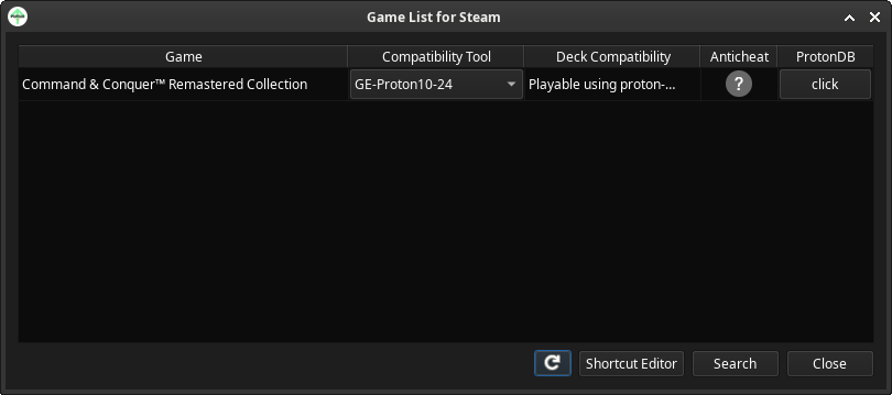

i checked protondb and didnt find any infos just one with a demo. On steam its say yes to Controller also recommended. Did you try other Proton Versions? you can use Protonup-qt to download other Protons and apply it but ther steam should be completly closed.
sudo pacman -S protonup-qt
