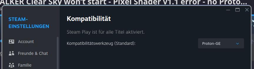

  • Proton: GE-Proton10-10, correctly installed and forced for this game

  1. Forced GE-Proton10-10 from Steam game properties

I didn’t know this and result on my test system…
I think I’ll learn a bit of Arch before diving into the Linux gaming scene with Garuda. I got into this without knowing much more than how to install LibreOffice on Ubuntu. I’ll be back. Thanks for the help.
As from the screenshots, you’re running an ancient proton version. Get the latest proton from GE by installing ‘protonup-qt’ and use that GUI to download the latest. Then try again.
I must be sleepy. I mistakenly thought the steam screenshot was from the thread starter. My bad.
yes..right and no prop.. it’s late. :upside_down_face:
In addition not all games are compatible with the latest Proton version. Some games require older versions. Therefore, “outdated” is the wrong term.
