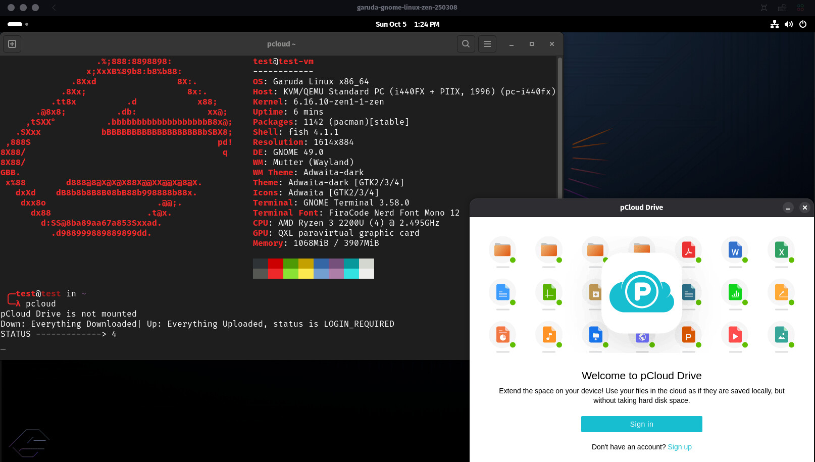

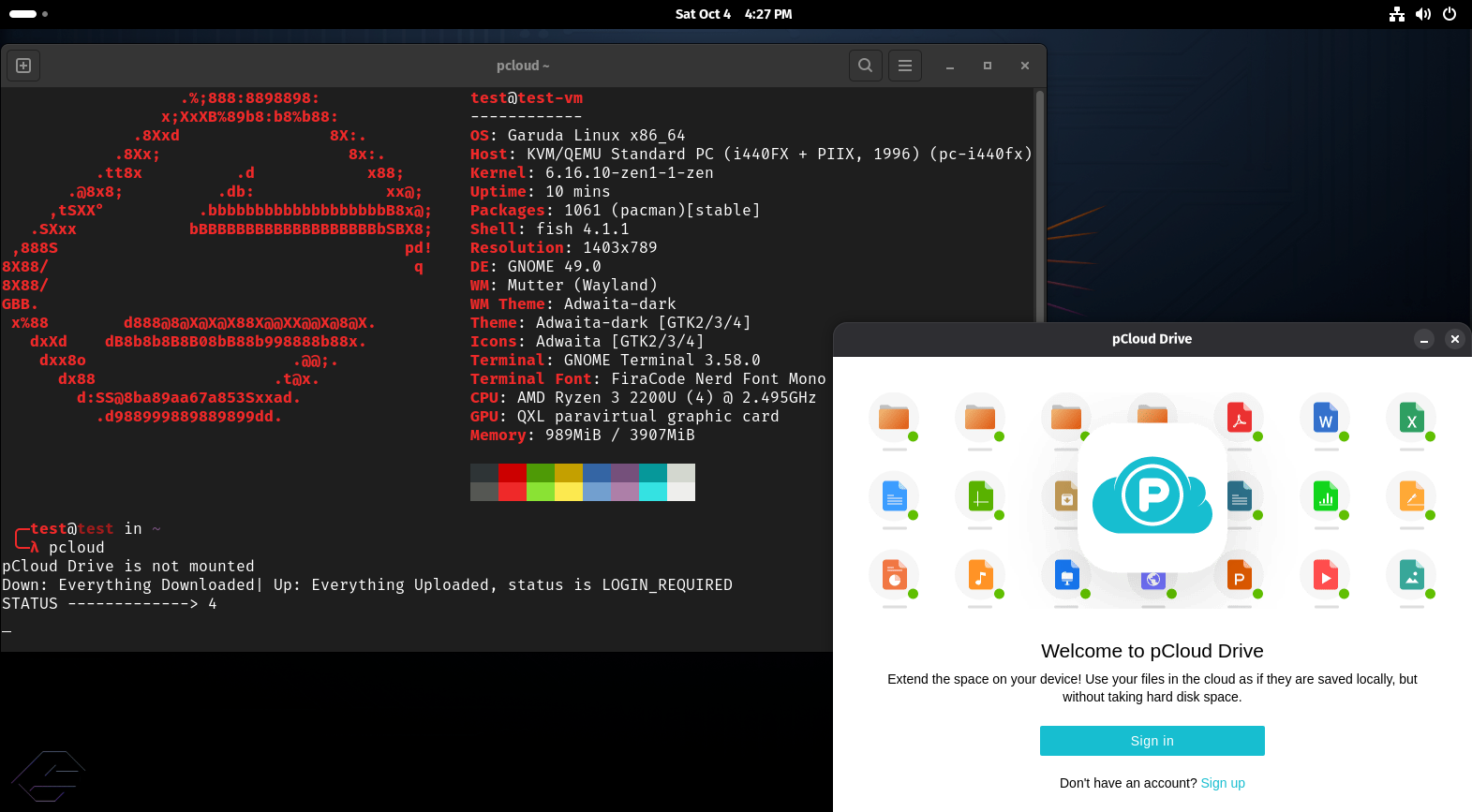

I quickly tested it in a VM - Garuda Gnome (garuda-gnome-linux-zen-251002.iso) fully up to date. Installed pcloud-drive from the AUR and it launches OOTB (I can’t test it further due to lack of an account).

I tested exactly this scenario yesterday with an older Garuda Gnome ISO (garuda-gnome-linux-zen-250308.iso) to check whether pcloud still works after updating to Gnome 49 – and it works without any issues:
clean install w/o updates
after the full system update
