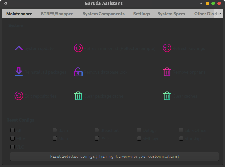

Problem:-
All QT apps(including garuda utilities) do not show correct dark-light areas. Like text is not visible when window is in focus.
Since when:-
Since I updated garuda 3-4 days back.
What I have done to solve this issue:-
I googled about this issue, I found this topic https://bbs.archlinux.org/viewtopic.php?id=258335 I tried all the solutions mentioned here but they didn't worked.

 ╰─λ printenv | grep Q
QT_QPA_PLATFORMTHEME=kvantum
QT_STYLE_OVERRIDE=kvantum
QT_SCALE_FACTOR=1
etc:-
  • Text can be seen after window is not focused, But theme is still ugly.
  • I tried to use kvantum but it didn't worked.
  • I have installed manual GTK theme and all GTK apps work fine.
  • I have changed fonts from settings manager.
Pictures
When not in focus:-
Use qt5-settings and kvantum.
The issue is solved. It was my bad.
I previously added environment variable in bashrc.
Now I have put it in profile. Everything works.
