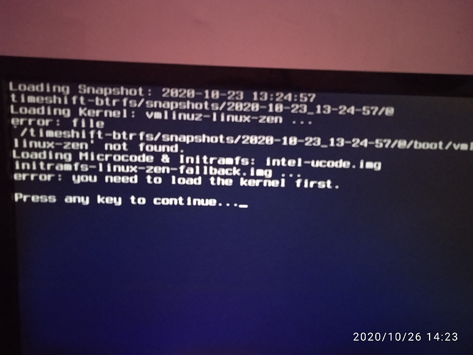

This is My problem. I can't to booting normally after entry on grub menu. I got a blank screen. So, I restarted with ctrl+alt+del. And I choose Garuda Linux Snapshot and rollback.
I get some error message :
Error: you need to load the kernel first

Try fallback image or alternative one
Still error.
Same message error : you need load to the kernel first

Yes, all snapshot giving same error.

I have done it through live boot, but it still gets an error. I've also done via Arch-chroot. Still get some error
