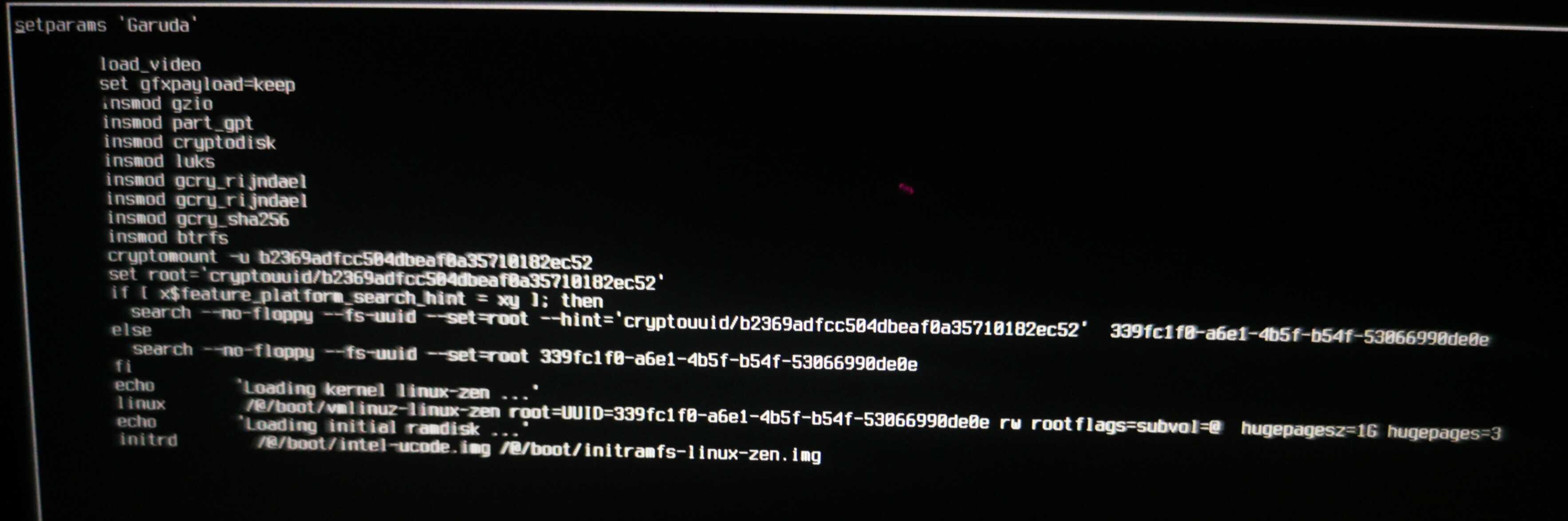

This happend after I added this command in /etc/default/grub :
GRUB_CMDLINE_LINUX_DEFAULT="hugepagesz=1G hugepages=3"
Then I sudo update-grub and rebooted and got to this screen.

Welcome, remove the line and did you try all snapshot’s?
Yes I tried all the snapshot. I tried to remove the line but I dont know how.
Use live USB (KDE) then use path and edit with kate.

How did you try to remove the line if you don’t know how?
Press e at the GRUB boot menu to access the Edit option (like it says on the menu) and then remove the part of the line you added (that broke things) and then boot using the shortcut key it tells you (F10).

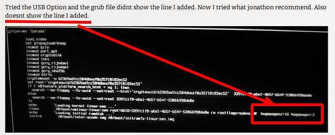

Tried the USB Option and the grub file didnt show the line I added. Now I tried what jonathon recommend. Also doesnt show the line I added.

How do I save the changes? I delete the command line press f10 and I get the same error. I reboot press e and the command is there again
This means the issue was not because you
and you must have made some other change.
I dont think I did. Do I need to delete "hugepagesz=1g hugepages=3" or the whole line?
You added only
therefore remove only that part.
