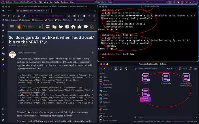

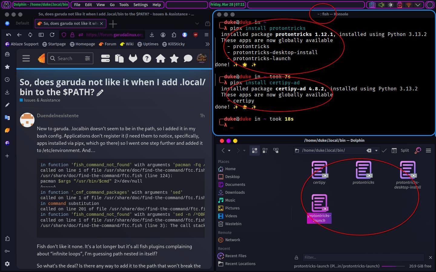

im not sure if i got you right but to this part here:
(I need them to notice, specifically, apps installed via pipx, which go there) so I went one step further and added it to /etc/environment. And…
did you mean this ?
Yep. And adding export PATH=~/.local/bin:$PATH to .profile, or /etc/environment freaks out the default shell.
okay? What do you mean with it freaks out the default shell ? which actions you did?
did install these fresh with pipx
cowsay -t hello

Yes its like BluishHumility says.
Its how you installed pipx correctly for using systemwide and adding the path correctly.
i did it a bit others on my kde with the terminal. ive downloaded a video and started also the video over the terminal without issues.
