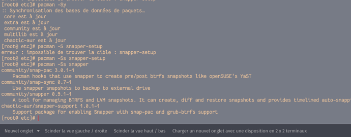

Thanks for providing a script to upgrade, however I couldn't find a way to install snapper-support, is it available through pacman ?
It says it couldn't find the package.
Do you have the chaotic-aur configured in your pacman.conf and synchronized the db?
After the upgrade, I can now see the new garuda assistant 'Harpy Eagle' and all. It seems like I was missing a lot of updates. Thanks !
However still no access to snapper-setup package:
Any idea why ?
Read carefully, snapper-support is the package name
My bad
, I got it working now.
Thanks for your patience with dumb guys like me!
