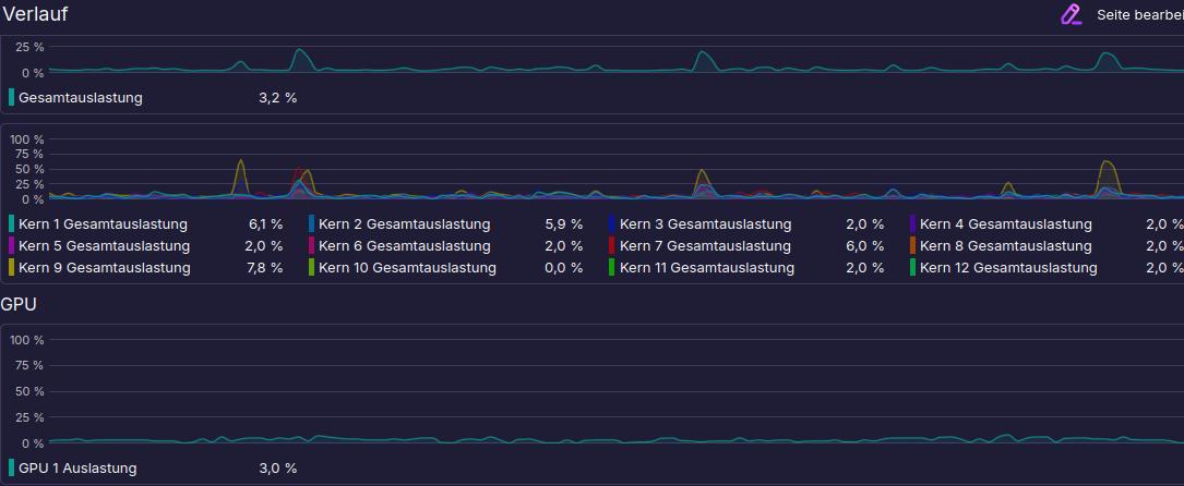

my example

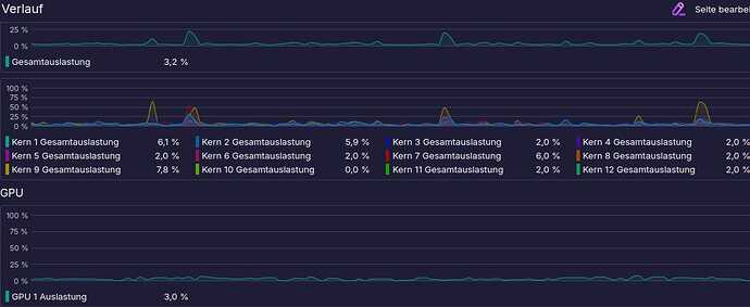

browser with 11 tabs open (1x playing you tube video), vlc open + video, systemmonitor, konsole, steam (no game running)
But it`s not a laptop + amd + amd (no igpu) and another kernel.

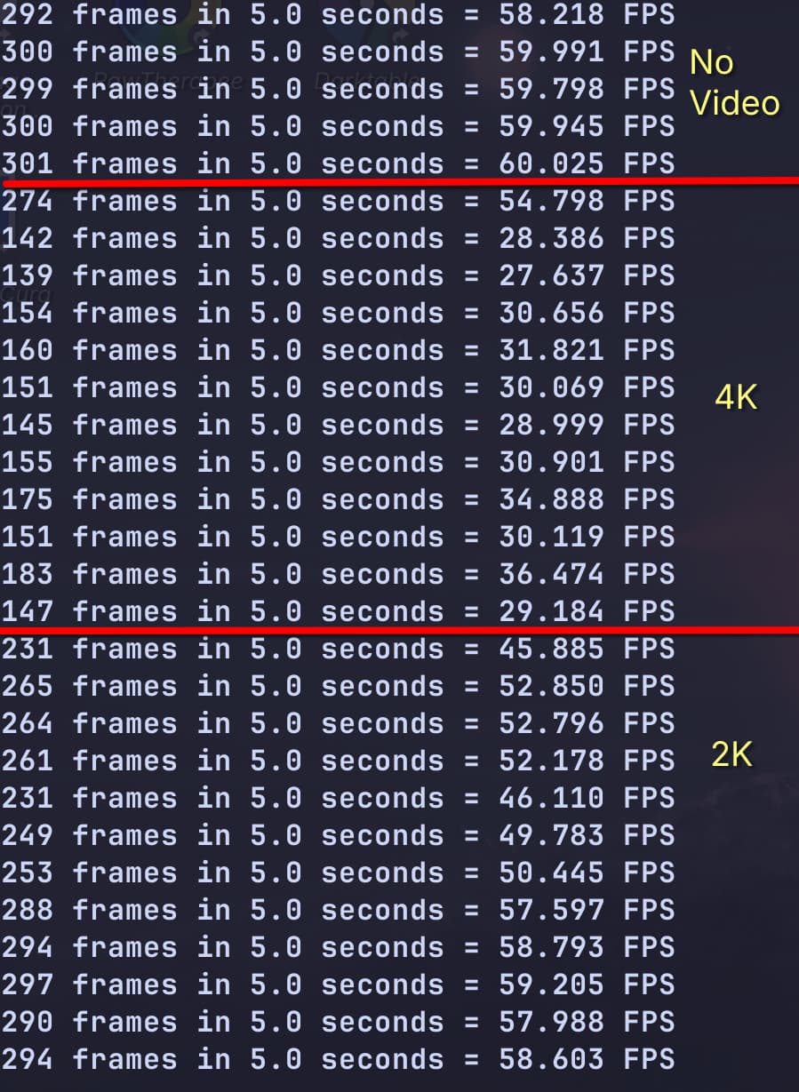

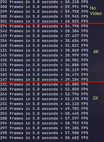

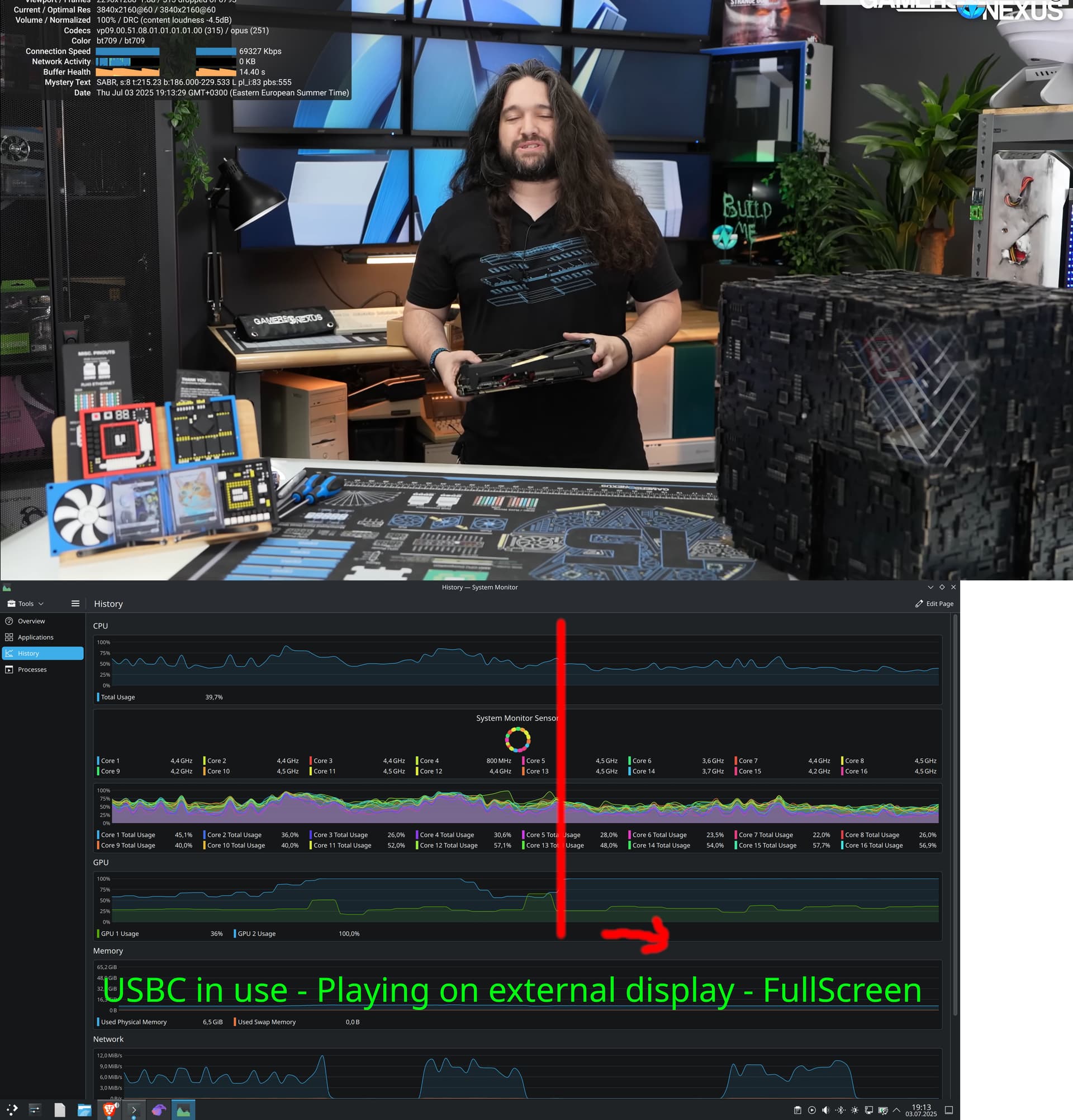

Nice, so your GPU stays at almost 0. That’s awesome.

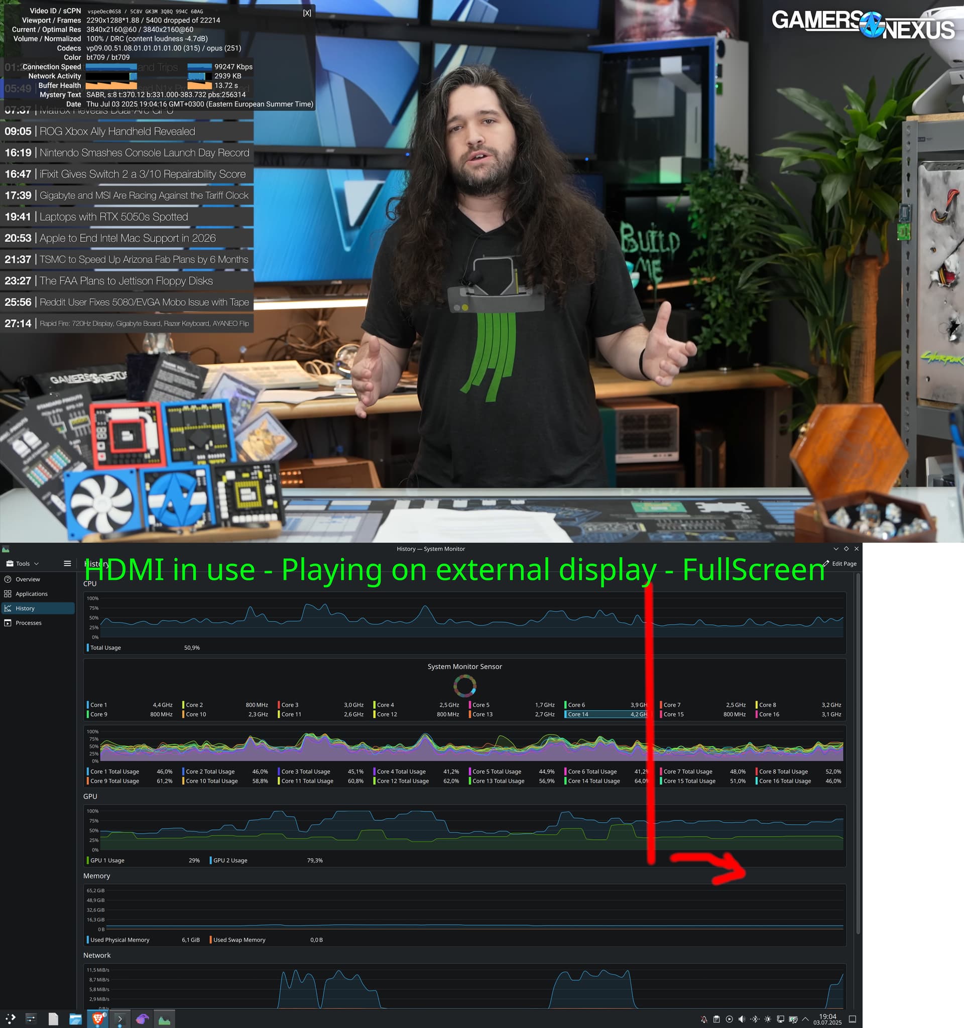

In my case it’s still at 80% - 100% with just a youtube video tab opened, but not even playing. If I start playing it I get a lot of dropped frames, even on the main laptop display:
This is at 2k. If I switch the video quality to 4k, it’s far worse.
I tried various ways:
  • run brave on the intel GPU - got about 10 FPS
    brave --enable-features=VaapiVideoDecoder --use-gl=desktop --ignore-gpu-blocklist --ozone-platform=x11
    brave --enable-features=VaapiVideoDecoder --use-gl=egl --ozone-platform=wayland
  • run youtube in MPV with mpv --ytdl-format=bestvideo+bestaudio "https://www.youtube.com/watch?v=7AcG44TC2-A" - same issue
  • run mpv on the intel gpu with _NV_PRIME_RENDER_OFFLOAD=0 mpv --ytdl-format=bestvideo+bestaudio "https://www.youtube.com/watch?v=7AcG44TC2-A" - same issue

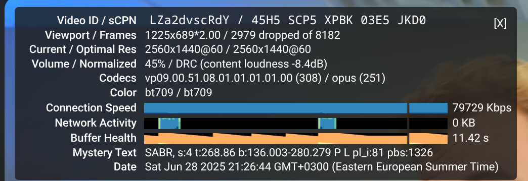

  • Run youtube videos in brave with the h264ify extension active. Max 1080p. works ok, but 1080p works almost ok without h264ify as well
But if I open a 4K video that I filmed, x264, it works great. No stuttering, no nothing. Just works.
So it almost seems like there’s a problem when playing VP9 videos from youtube. Or even just having youtube open with the video paused.

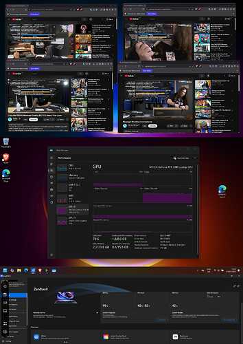

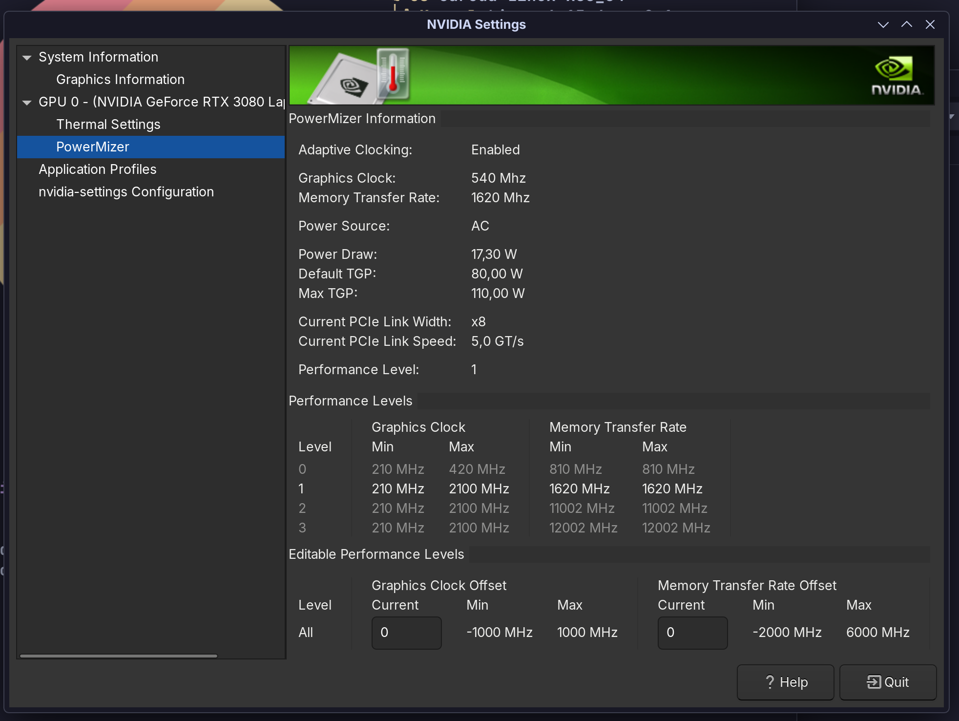

One thing about this laptop is that in windows it has 3 modes that I can use, and I can toggle them from a dedicated button: Quiet, Balanced and Performance. Nothing unusual so far, but the “Performance” one immediately turns on the fans at almost max speed, and it requires the AC adapter to be plugged in. if it’s not, I get an overlay on the screen saying that the performance mode is only available with the AC adapter.
I’m not seeing such a limitation on Linux, so maybe the laptop is not going to full power?
I mention this because the current performance is similar to Windows in the “quiet” mode.

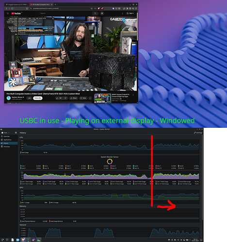

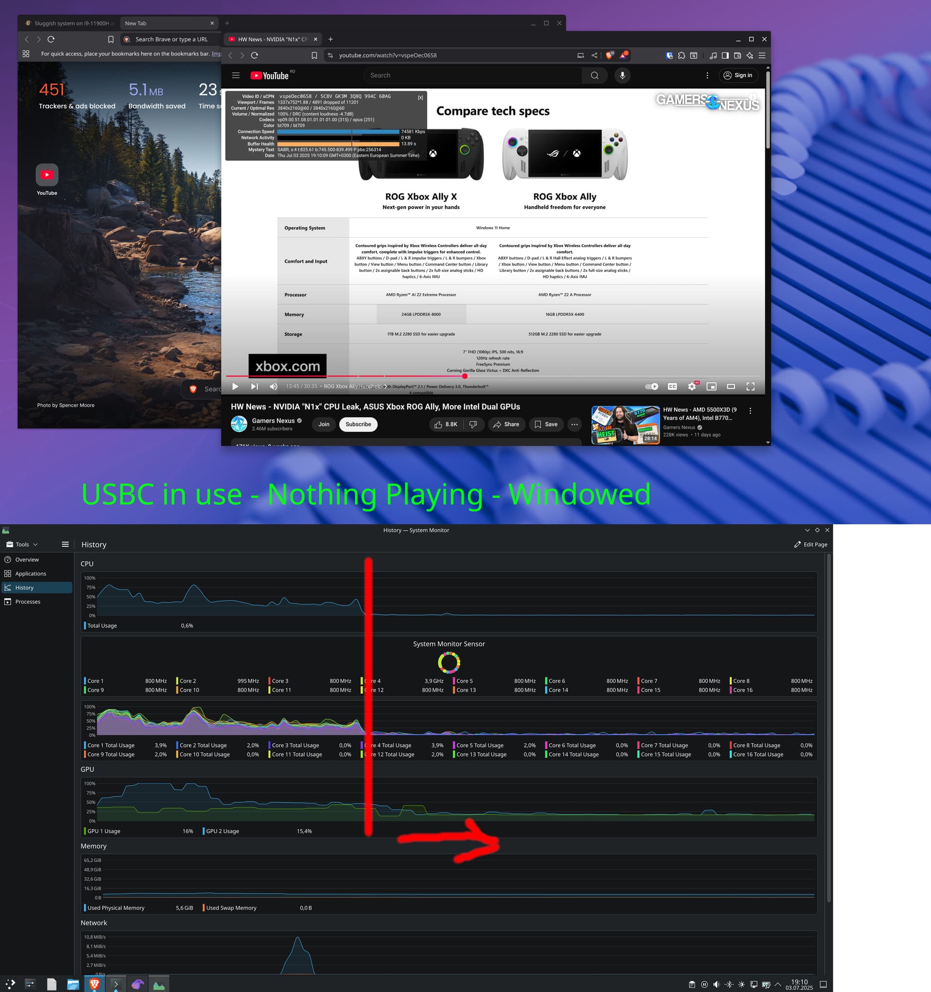

I also got a new Thunderbolt 4 cable for my display.

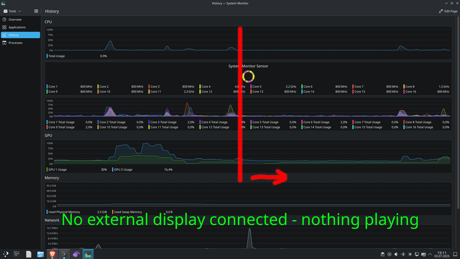

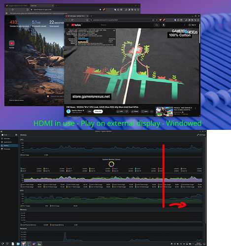

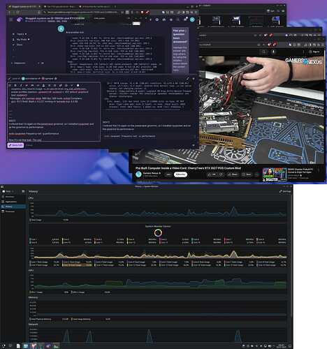

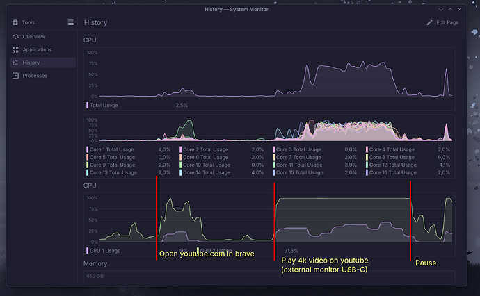

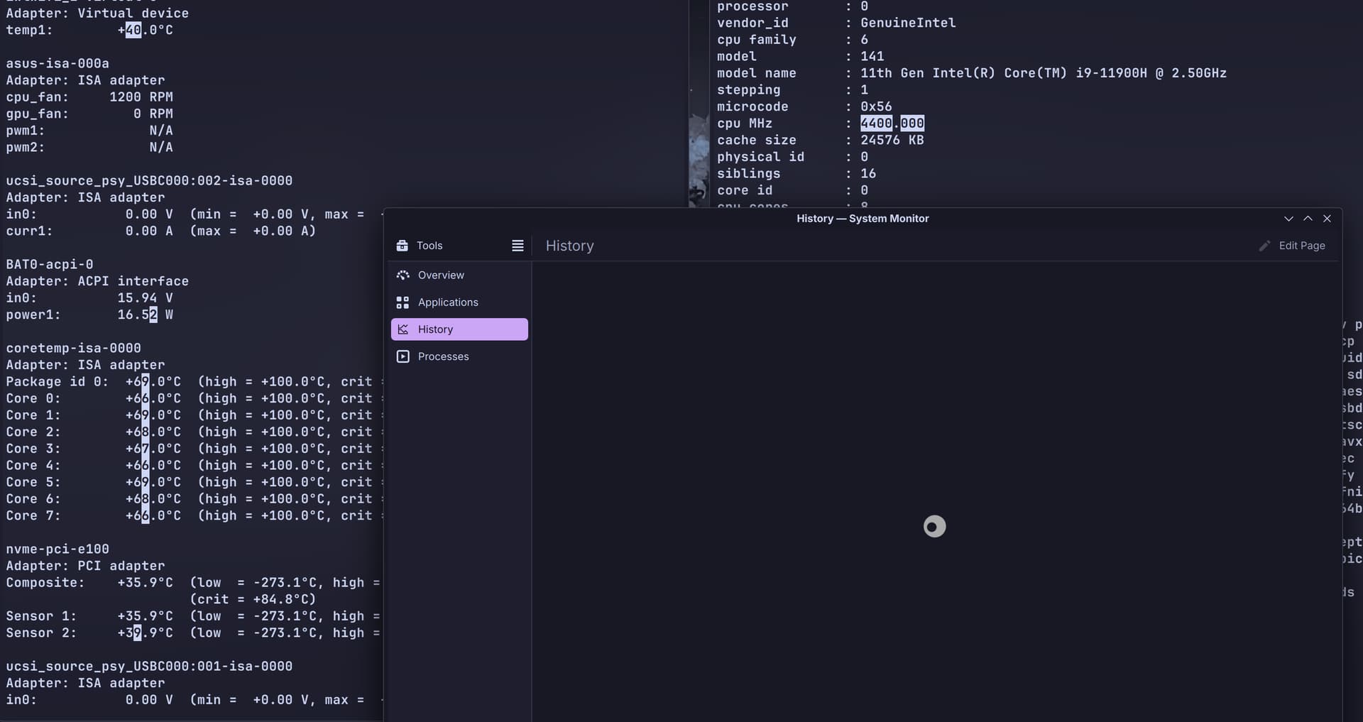

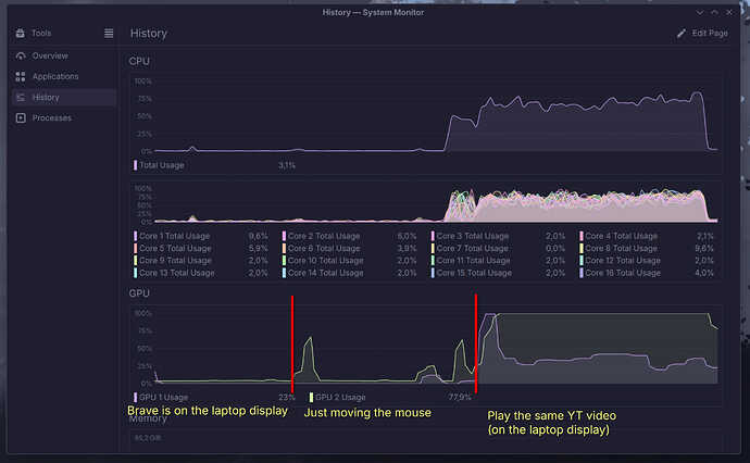

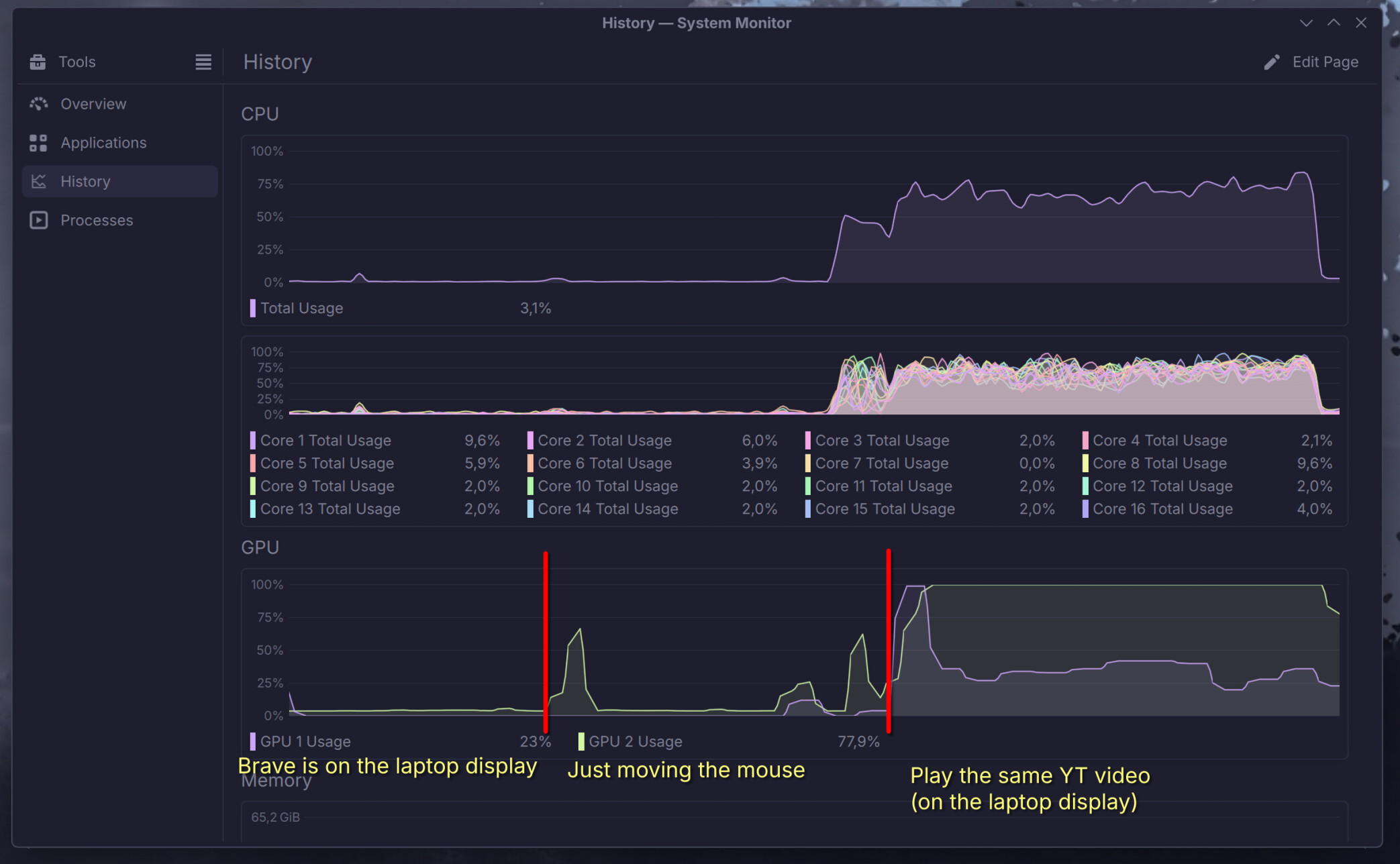

So the situation now is that the system overall seems more responsive, but only when youtube videos are not playing.
If any youtube video is playing, everything else stops working. Even the system monitor charts stop moving.

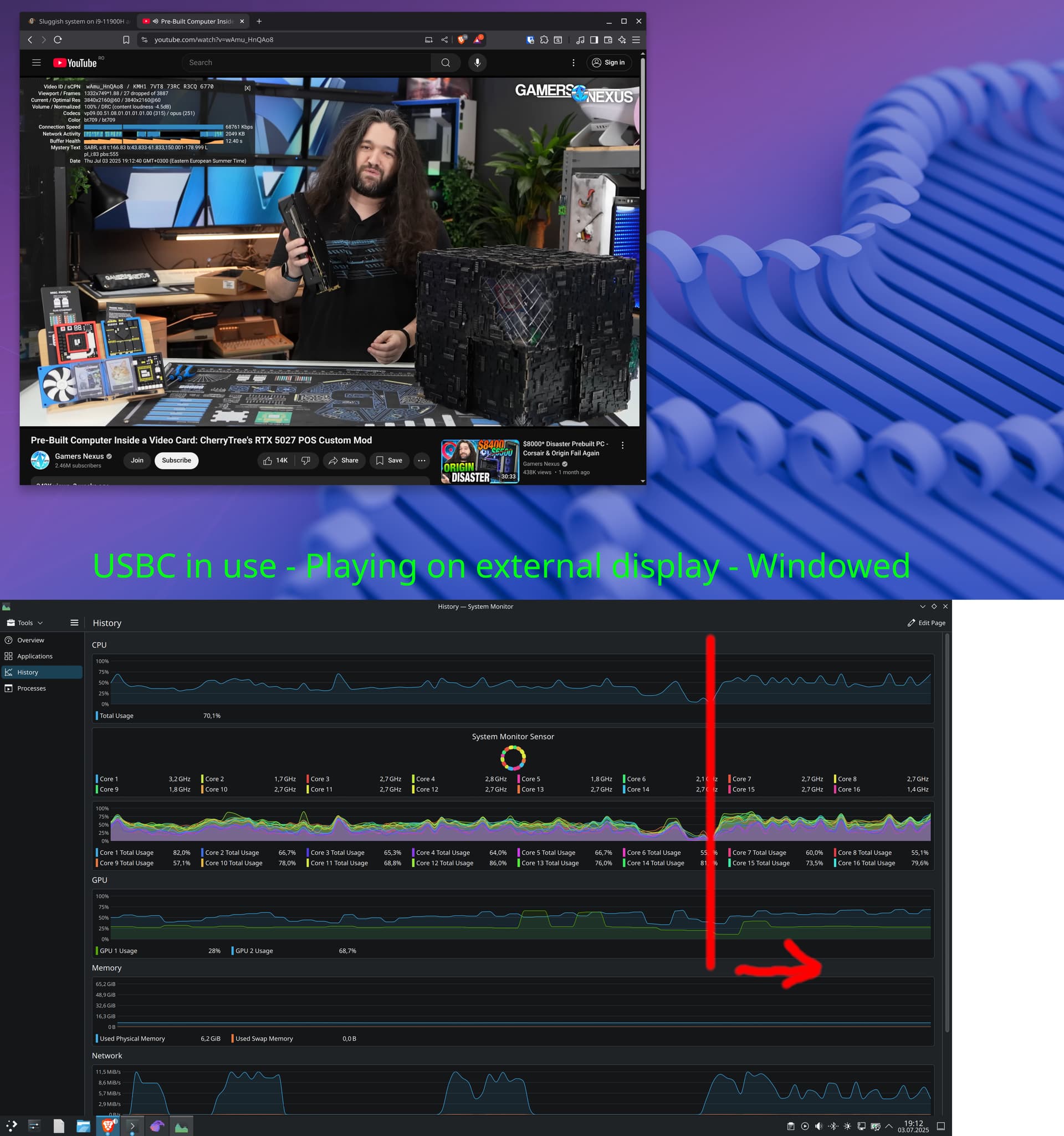

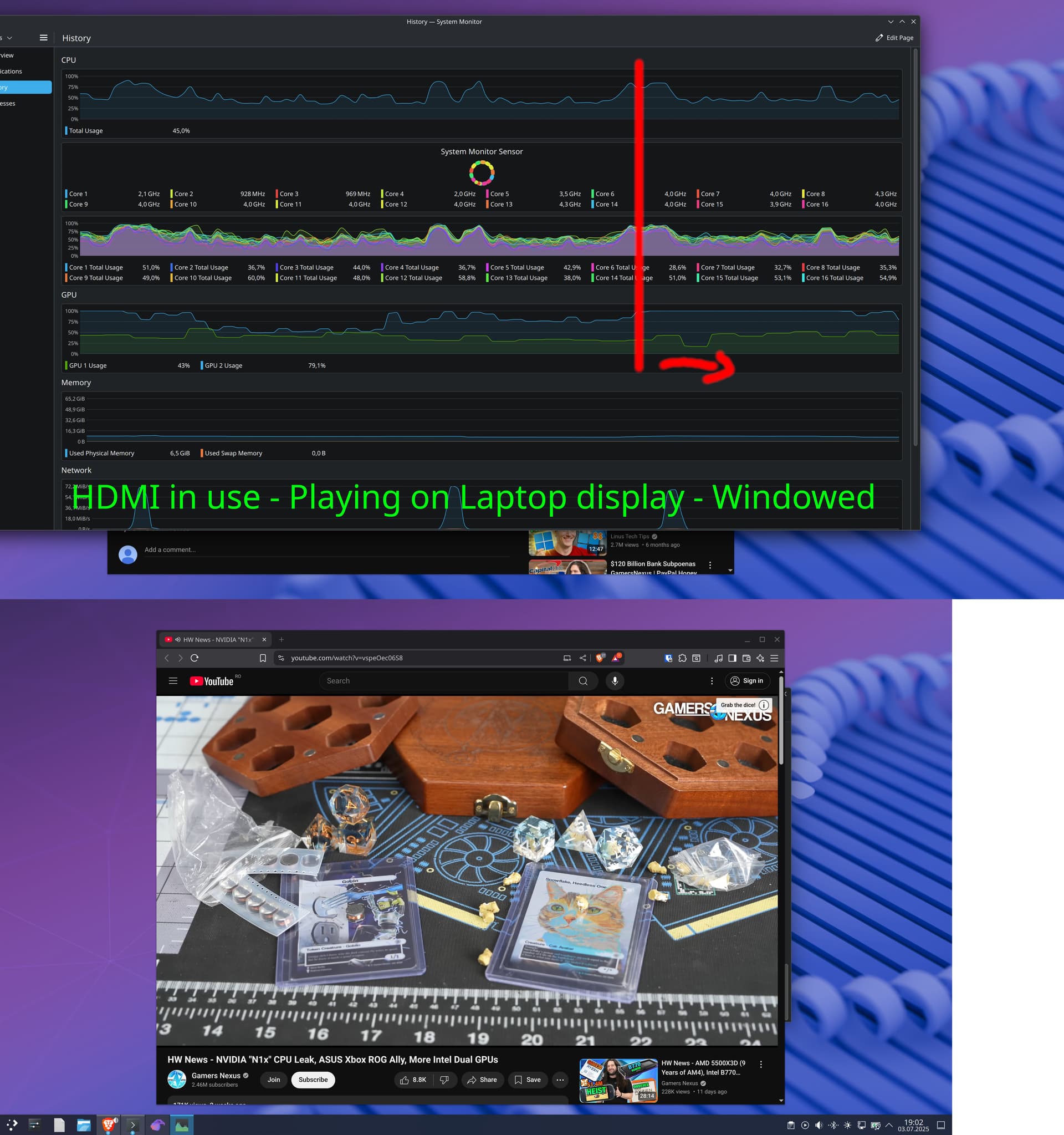

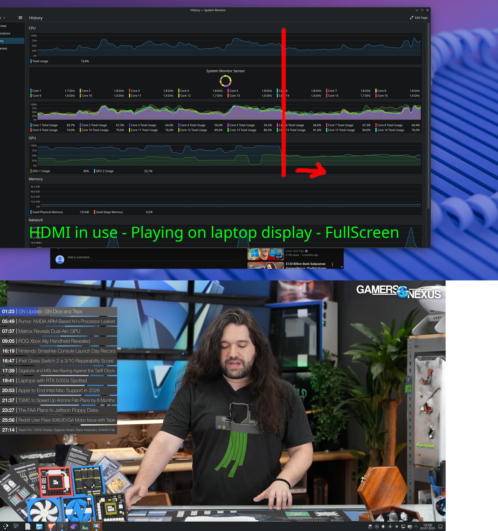

Here are a 2 charts, I’ve annotated them with what I was doing when the spikes happen.
First, on the external USB-C display:

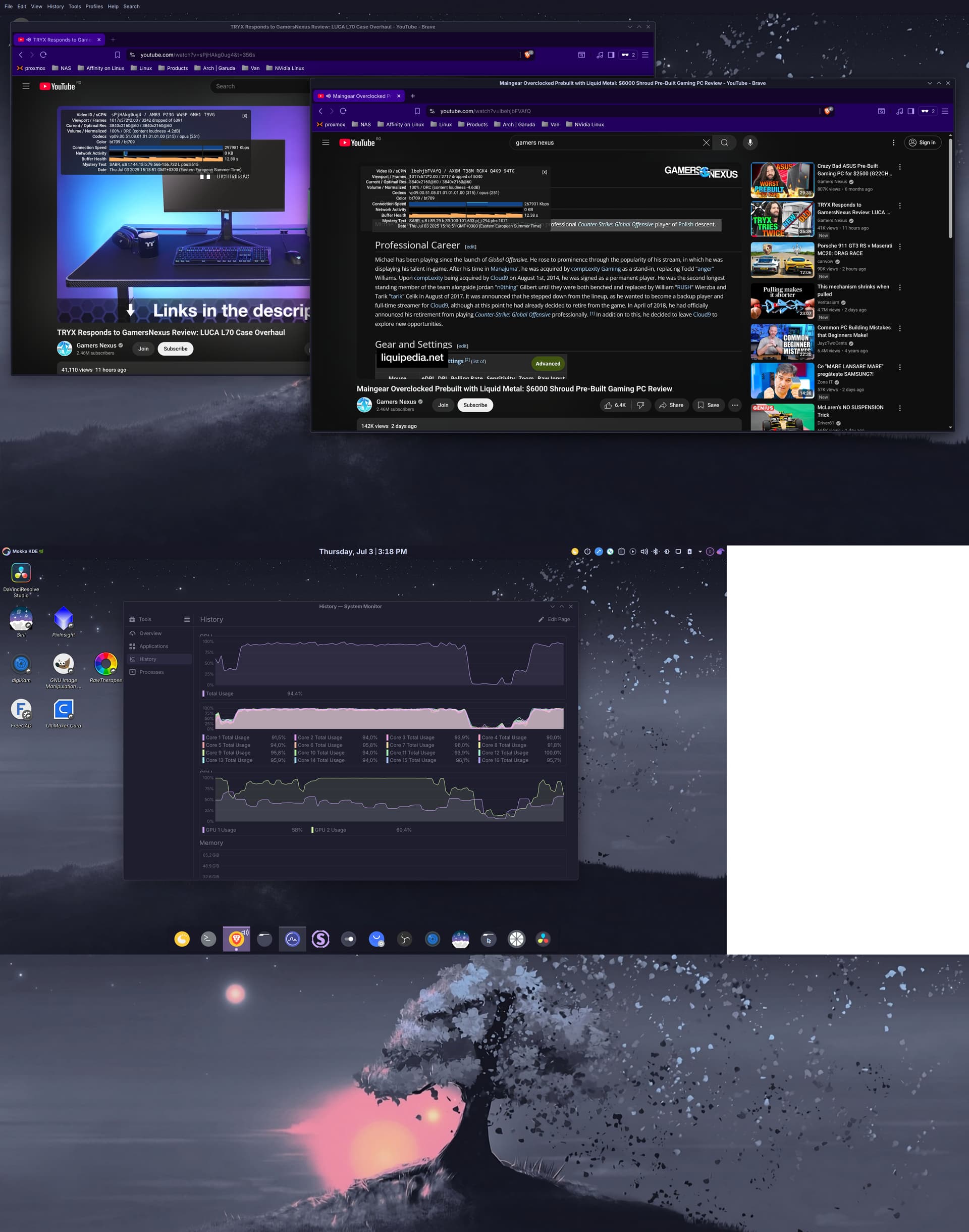

Second, on the laptop’s main display:
I had nothing else opened. Only Brave with 1 tab on youtube and the System Monitor on the History section.
What is wrong with this laptop on Linux? I can’t be the only one experiencing this issue on a combination of i9 and RTX3080 Mobile.
Any ideas on what else I can try?

Why does it say this?:
compositor: kwin_wayland driver: X: loaded: modesetting,nvidia dri: iris
gpu: i915 resolution: 1: 3840x2160~60Hz 2: 3840x1100~60Hz 3: 3840x2160~60Hz

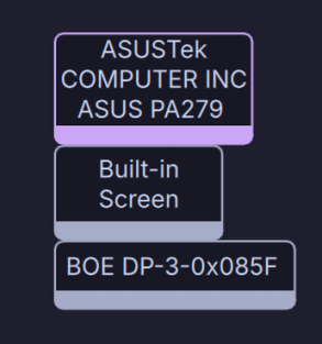

This is my display configuration:
[EDITED] Didn’t see the 3rd one listed there.
Am I to understand that the intel GPU is handling all the displays?

But when I have the display connected on USB-C and inxi -e says only i915, if I run nvidia-smi I get this:

So why are all the processes there if my only display gpu is the i915?

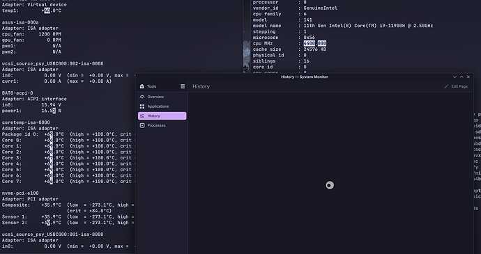

After all this, I think the video playback is a bit smoother on 4k videos but still the rest of the system becomes almost unusable.

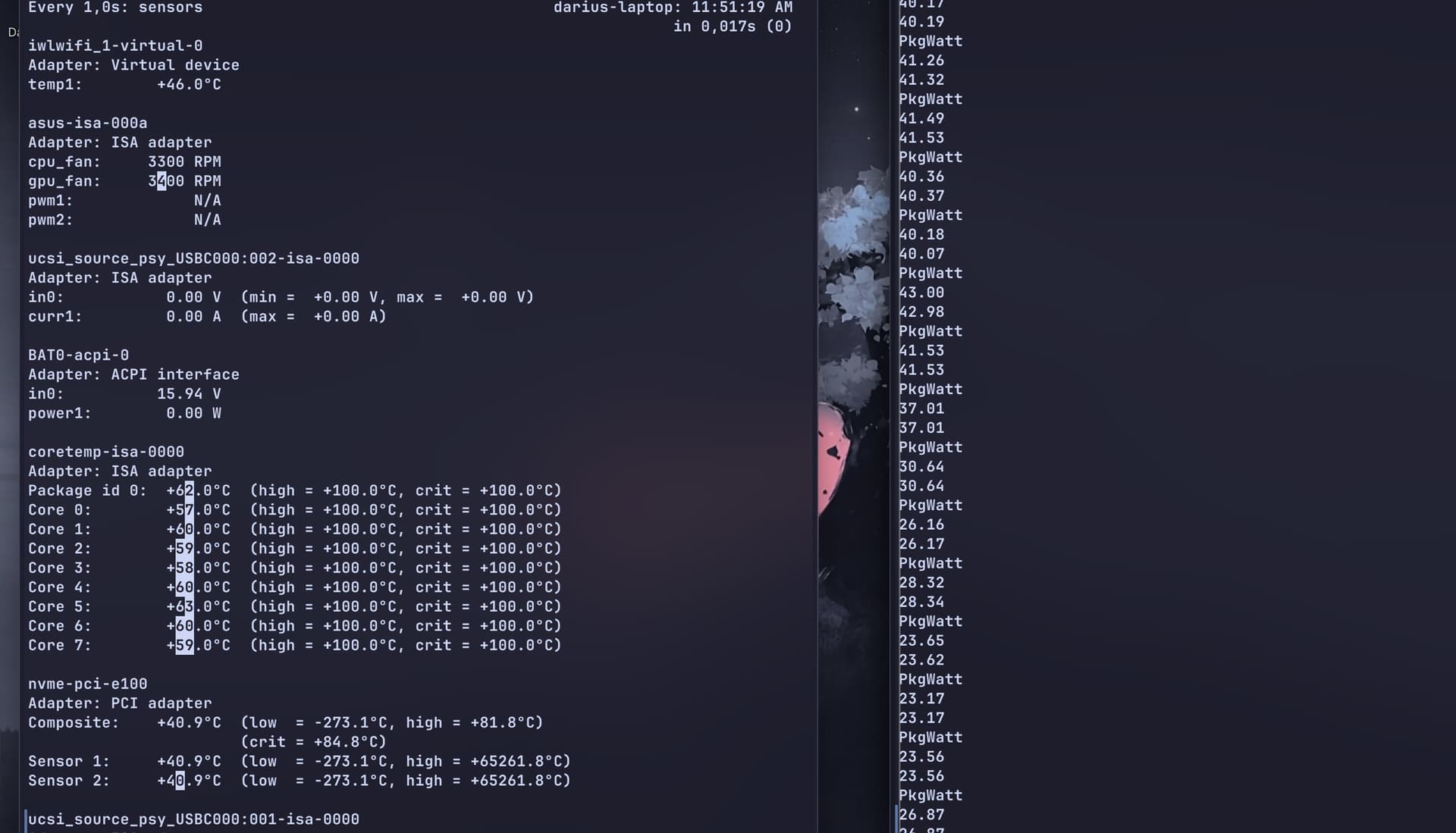

So in 2 different terminals I’m running:
watch -n 1 -d sensors
and
watch -n 1 -b -d cat /proc/cpuinfo
When I play the video the temperatures go up to 80 C or so, and I see the frequency going from 4GHz down to 1.6, 2 and sometimes 800MHz.
Not sure what to make of it. The fan isn’t spinning too fast. I tried various ways to make the fan run at max speed always, but I couldn’t get it to do it.

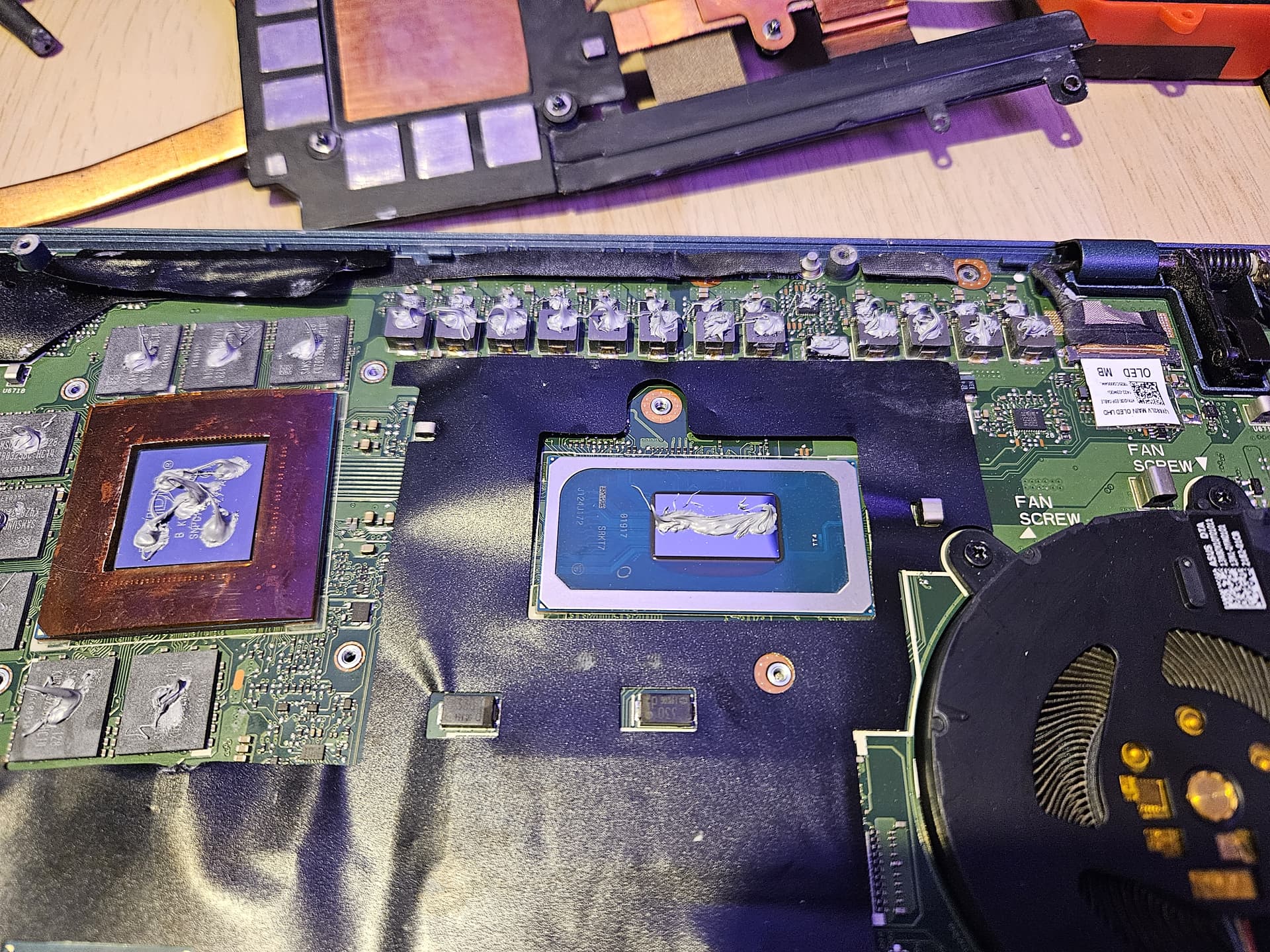

Like @gampel said, I’m going to change the thermal paste again, but I’m not sure what good can it do if the fans don’t spin fast enough to evacuate the heat.
Buy a laptop cooler (if possible), perhaps replace the cpu cooler.
Take attention that all components are installed correctly, heatpipes etc.
And pls test your sysem without intel igpu (over bios)+ install another kernel.
Use sensor tools example btop with the right settings (not for your system but default amd gpus are not really checked) or if you like M$ style install hardinfo2 with the correct settings.
(daemon is running + user /group settings) and use nvidia-smi additional.

I just changed the paste. This is Arctic MX4. I made sure all screws were tightened correctly and the paste is applied on all the components where there was originally paste from the factory.

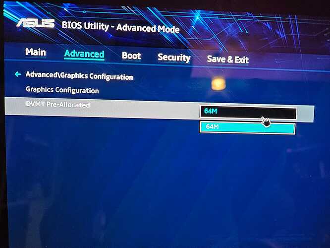

I don’t have an option in bios to disable the igpu
This is just after the computer started, opened youtube. Not even the System Monitor app will start properly. It just stays like this until I pause the video. After I pause, everything returns to normal and the charts are shown.
Yes, I tried prime and many others like supergfxctl.
nvidia-smi shows activity but still my system becomes unresponsive until I pause the youtube video.
This is while a video is playing. Screenshoting is very very slow when videos are playing, but the Performance Level went to 3 then back to 1, and it kinda moves around but stays mostly on 1 while playing videos. Goes back to 0 when not playing.

Option “IGPU Multi-Monitor” ( about F7 knowledge from asus)
Sorry, btw, what you are doing, believe me not like this.
many many to much paste. 1 small point. in the middle of the spreader then credit card or similar flat over it and distribute evenly → rdy. (paste only on spreader not like this (picture)
More is not better there. If you have too much (see pictures) it goes reverse.
The pipes / tapes / metal blocks must sit flat.
It’s not the paste, that’s fine. I tried all options. Blobs like I did now, I also tried a thin film like you said, I tried all, the result is the same. Everything works fine on windows, but everything breaks on linux & wayland when I play a 4k video on youtube.
If I install windows now, I can play multiple 4K videos all at once while I compile a .net app, no issues. This has to do with software, not hardware, and now I have the proof:
The picture below shows that while playing a video, my cpu is at 60 C while drawing 43 Watts. This CPU is rated at 45, so it goes to its maximum and does not throttle down.
The point where it went to 30 then 20 is when I paused the video to take the screenshot. I can’t even take screenshots when a 4k video is playing.

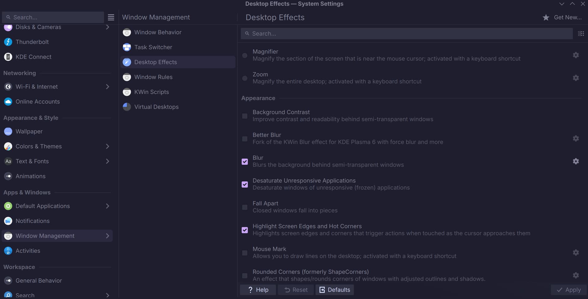

I think I resolved it.
Still evaluating, but:

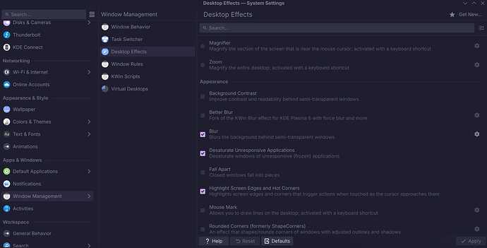

What I did is I disabled “Better Blur”, Zoom and “Overview” in System Settings → Window Management → Desktop Effects, and restarted.
I got some weird transparent popups for Bluetooth and other stuff in the top-right, so I enabled “Blur”. The simple one, not “Better”
I’m now playing a 4k youtube video in one of the 20 open tabs, and I can do a screenshot at the same time. Everything is smooth, I’m so happy!!!
I’ll report back if the issue reappears, or if after a few days I can deem it completely resolved.

But for the past 2 weeks I could barely do any work because of all these performance issues.
I though linux was supposed to use my hardware more efficiently than windows. All over the internet I see articles about “bring your old computers to life with linux”. Well my experience has been quite the opposite, unfortunately…
Please, someone with a RTX+intel laptop, could you try to open 2 4k videos at the same time and see if you’re getting the same issues?
Some more things that I tried:
watch -n 2 nvidia-smi --query-gpu=pstate --format=csv
With this, I see that the gpu is going to P0 when I start playing videos, so it is going to full power. But nvidia-smi only shows about 20W of usage, not sure what’s going on or why isn’t it going to 100W if it’s struggling. P0 should mean that it goes there no matter what.
❯ sudo turbostat --Summary --quiet --show Busy%,Bzy_MHz,IRQ,PkgWatt,PkgTmp,RAMWatt,GFXWatt --interval 3
Busy%   Bzy_MHz IRQ     PkgTmp  PkgWatt GFXWatt
1.64    3181    14973   54      10.74   0.30
18.19   3344    40023   70      26.96   4.49
26.66   3596    48236   72      40.24   6.56
25.99   3468    45974   72      38.05   6.57
26.16   3563    47422   63      40.21   6.68
23.47   3518    44360   64      35.76   6.43
29.56   3357    50212   81      37.31   6.35
23.19   3453    42796   65      36.38   6.58
24.17   3352    42930   68      35.98   6.48
26.78   3372    45563   66      38.02   6.45
21.28   3548    42672   90      36.77   6.63
18.61   3691    42903   68      35.59   6.57
This shows that the CPU does go to high power and doesn’t throttle down or anything.

I’ve just booted from an ubuntu live usb.
I can play multiple 4k videos at the same time, absolutely no stutter, nothing, zero dropped frames.
I’m on wayland, ubuntu 25.04 (latest)

This is with glxgears.
Before I start any video, I’m getting 60fps, which is the monitor’s native 60Hz
When I start a youtube 4k video, it goes way down, to 30
When I switch to 2k on the same vide, it goes back up to 50 or so
When open another tab (but the video keeps playing in the background), then it goes back up to 60fps.

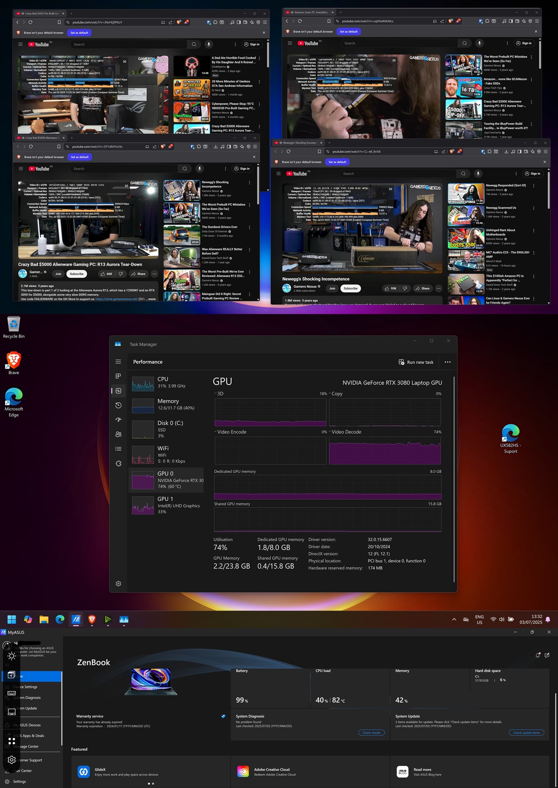

I have another update.
I installed Windows 11 clean. Then installed the nvidia drivers, thunderbolt and MyAsus.
I can play four 4k videos at the same time with barely any dropped frames. And this is in the “Balanced” mode, it’s not even in Performance. I mean the screenshot is taken in Performance mode but it works the same in “Balanced” as well, the only difference being that the CPU goes close to 90 C (which is normal for this cpu, not a problem until 100).
Also I can take screenshots and I’m writing this post while the 4 videos are still playing, I’m not seeing any stutter or any slowdown in anything else. Oh, and the display is connected via HDMI, didn’t even have to go to USB-C.
So this tells me conclusively that it’s not a problem from hardware, thermal or anything else related to my specific laptop.
Another thing to mention is that I have sound now on the integrated speakers.
So please, if anyone has any ideas as to what could be the issue in Garuda+KDE?
I’m going to try to transfer this installation of Windows to an external SSD so I can reuse the internal SSD for tests with Garuda+xfce and other distros. I am beginning to get a bit frustrated.
Sorry for the poor quality of the image, there’s a 5 MP limit for uploads from Windows.
For comparison, I booted Garuda and I took this other screenshot. With only 2 videos, notice how the CPU usage is much higher:
  • the dip in cpu usage is when I paused the videos to be able to at least start the screenshoting tool.

I’m on kde-lite now. It does seem a bit faster, but the issue is still here.
I’m on a clean install, with nvidia installed like this:
I’ve also installed plasma-system-monitor to see what’s going on.
With 2 browser windows opened, each playing a different 4k video on youtube, I’m getting the same issue .
The RTX stays at about 25% utilization and the intel gpu goes to 100%.
The CPU also goes to 100%.
Even with 1 video, the CPU goes to about 50% utilization.
If I start brave with prime-run brave, I’m getting both GPUs at about 50% and the CPU also at about 40% with only 1 video playing.
I don’t know how to take screenshots now in kde lite. Winkey+shift+S doesn’t work like in Mokka.
This is with the display connected over HDMI. I noticed that on windows, without the nvidia drivers I don’t have hdmi output, so I’m guessing the HDMI is connected directly to the RTX.
I’ll see with the kernels that you mentioned.
[EDIT] It seems that in plasma-system-monitor the intel GPU goes to 100% and 5 seconds later the CPU goes to 100% while garuda rani is doing dkms install --no-depmod nvidia/575.64.03 -k 6.15.4-2-cachyos
If you install relevant software…special kernels..that’s “normal”
Believe me, if my system is compiling a kernel… then … it looks the same with cpu usage and a “little” longer. :upside_down_face:
Ok, then that part is fine.
I did a series of screenshots, perhaps they can tell the story better than I do.
External display is on top, laptop display is on bottom.
I didn’t include the smaller secondary laptop display, it’s empty.
This is all on cachyos kernel:
 ╰─λ uname -r
6.15.4-2-cachyos
  1. External display on HDMI. Video playing on Laptop display, Fullscreen.
  2. External display on HDMI. Video playing on Laptop display, Windowed.
  3. External display on HDMI. Video playing on external, Fullscreen.
  4. External display on HDMI. Video playing on external, Windowed.
  5. External display on USBC. Video not playing, it’s paused.
  6. External display disconnected
  7. External display on USBC. Video playing on external. Windowed.
  8. External display on USBC. Video playing on external, Fullscreen.

[EDIT]
I noticed that i’m again on the powersave governor, so I installed cpupower and se the governor to performance:
sudo cpupower frequency-set -g performance
Now it’s not that bad. The cpu stays at lower utilization while a video is playing. But still it’s at about 25%. I can play 2 videos at the same time with about 10% dropped frames.
I’ll try this on my Mokka installation see if pstate performance is better than disabling pstate from grub.
