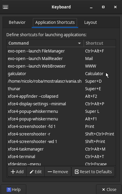

I have a problem:
I have a keyboard shortcut that launches a script that shows the desktop, but when I press the shortcut (super+d), the menu opens.
Video: whisker menu behaves strangely

It might be helpful to see the script. Can you confirm it runs/has the desired effect outside of the shortcut configuration?
Please explain your method for configuring the keyboard shortcut.
I showed the script and the method in the linked video.

script is:
if xprop -root  _NET_SHOWING_DESKTOP|egrep '= 1' ; then
  wmctrl -k off ;
else
  wmctrl -k on ;
fi
and I set the key for it using the app keyboard:
I believe the meta key is assigned to open the whisker menu:
That is "Super L" (as opposed to "Super+L"), which I interpret to mean the meta key on the left-hand side of the keyboard.
Try to change or delete that shortcut and see if your custom shortcut works without opening the menu.
Yes, if i remove it everything works
