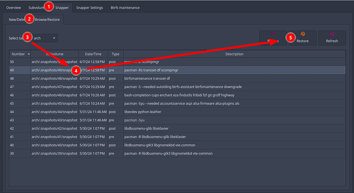

In my opinion, using the mighty Btrfs Assistant to restore snapshots is the best way. It is easy, fast, and prevents making mistakes when you are doing the restoration.
To a restore a snapshot with this tool, click the “Snapper” tab, then the “Browse/Restore” tab within it. Choose the subvolume you want to restore a snapshot for, pick the snapshot you want to restore, and then click “Restore”.
You can restore a snapshot with this same method regardless of whether you are booted into the subvolume you are restoring a snapshot for, or just mounting the Btrfs partition when booted to the live environment or booted to a Btrfs snapshot. Btrfs Assistant has command-line options as well, if you want to restore a snapshot from a TTY for example.
