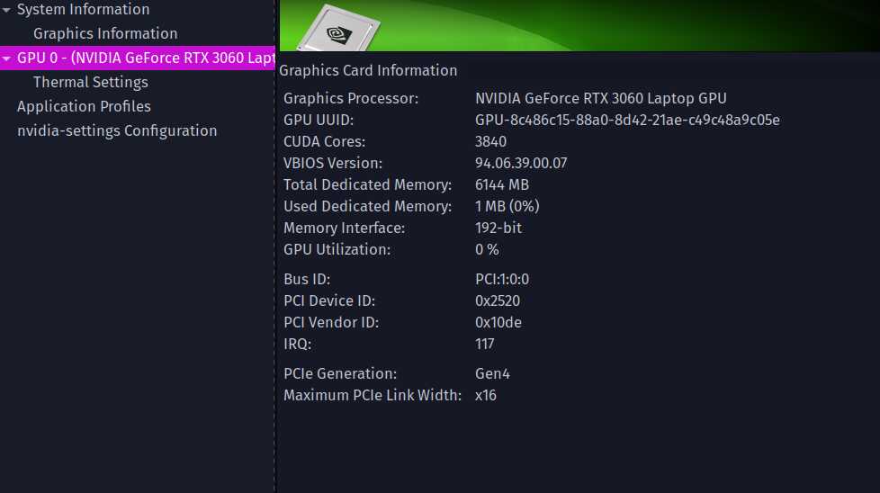

This is my nvidia-settings ( the graphics info section is empty)
