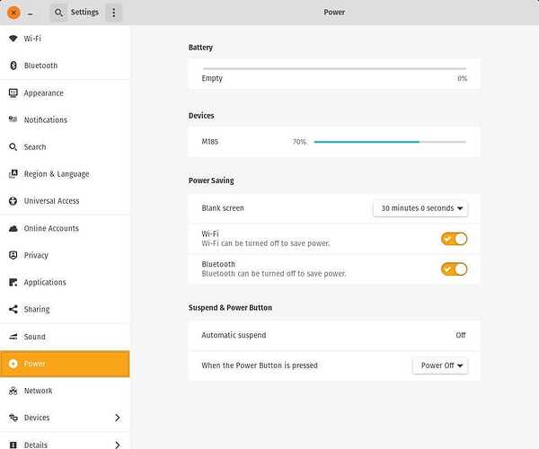

Hi, recently (I think following an update) the screen timeout no longer works, even if I set it to 5 minutes, at 1 hour, my two monitors (the laptop one and the one attached via HDMI) switch off after about 10-15 seconds of inactivity
Being on gnome and doing some research I tried using the command
gsettings set org.gnome.desktop.session idle-delay 3600
but nothing has changed :frowning:
Any suggestions on where to investigate to solve the problem?

could you try setting the value via your settings?
Obviously that was the first thing I did, and since it did not work, I tried the command above.
OK, the problem has been solved and I think I know why.
I have a laptop with Nvidia Prime, and I use Optimus Manager to manage the GPU, optimus manger needs a window manager with modifications, so I installed gdm-prime instead of standard gdm. With the upgrade of Gnome to version 44.1, gdm-prime was still stuck at version 43 and was causing some problems. I just upgraded my system and noticed that among the packages to upgrade was gdm-prime.
