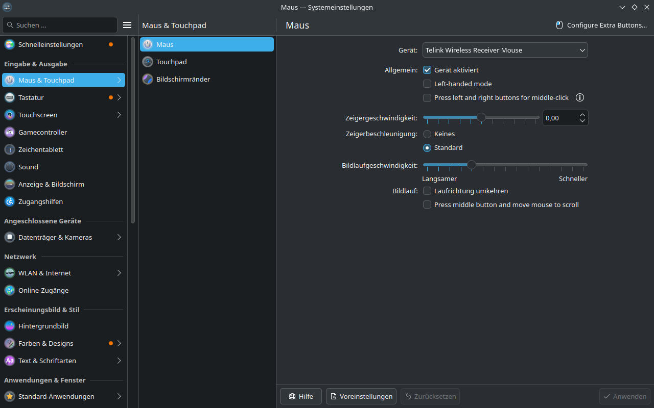

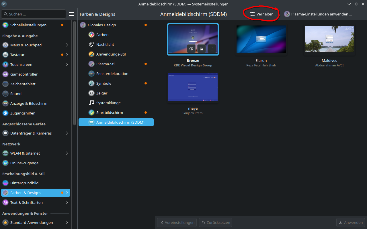

At login in the bottom left there is an option to switch to an x11 session or wayland?
I’m navigating with keyboard shortcuts, since now I can’t move my mouse to my other monitor, how do I fix this??
Can also be changed in the KDE settings.

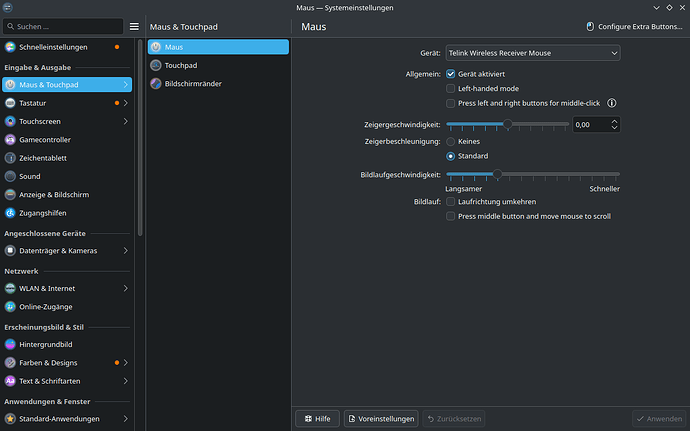

Wdym? I just logged out and in the X11 session it worked with my monitor but I still can’t move my mouse, what do I do? how do i get that fix in my plasma DE?
Is the mouse activated?
