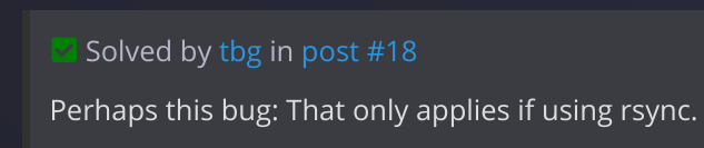

What now, solved or not solved?
If I understand all this correctly, you are not using Garuda’s default configuration. So your contact would be the Timeshift developer.
Garuda has been using snapper with Btrfs for some time, maybe you should not have used your ancient ISO, but a recent version.
That’s why I moved the posts.
Well, for me solved. As issue was that I couldn’t create a snapshot. Now I can. Just confirmed that rsync version is resposible and workaround with downgrading is needed.
