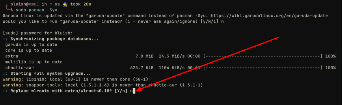

There is not much for it but to wait for the SceneFX devs to reconcile this insanity by at least updating the wlroots dependency in the PKGBUILD (to use one of the “new” repo packages, presumably wlroots0.18). For now I opened an issue for it here:
If you cannot wait and need to update your system right away for some reason, use sudo pacman -Syu and respond “n” to the prompt to replace wlroots.
You should be able to update fine this way, but the old wlroots package will remain on your system as a foreign package (installed, but not found in any repo) and you will get the same prompt to replace it every time you update.
