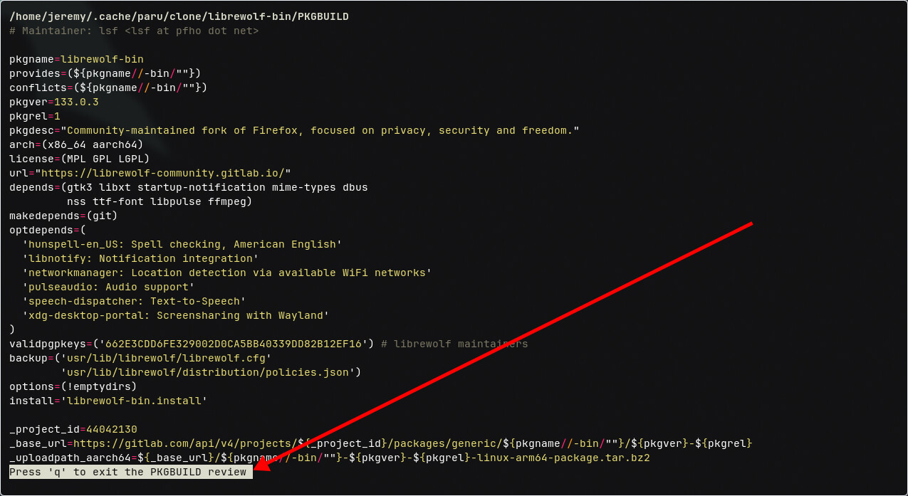

If the PKGBUILD is longer than can fit on the terminal screen, it gets passed to the pager. In this case, you will need to press Q to exit the PKGBUILD review and proceed with the installation.
I tried to find a solution from the command manual of paru as I didn’t figure out that. It would be nice if it said "press Q to proceed, instead of “END” - or actually I would like to have both. Thanks for your reply :slight_smile:
I agree actually, I think this would be nice. It has come up a fair many times that someone is “stuck” in the PKGBUILD review, because they are not familiar with using the pager and there aren’t any clues how to interact with it on the screen.
One thing we could do is change the prompt from a colon to a custom message, by setting the PARU_PAGER environment variable to use less with the -P flag (which allows a custom message in the prompt). I just gave this a shot on my machine and it works well.
Add this to your Fish config (~/.config/fish/config.fish):
# Hint to exit PKGBUILD review in Paru
set -x PARU_PAGER "less -P \"Press 'q' to exit the PKGBUILD review.\""
Then when you are in the PKGBUILD, that message will show as the prompt.
I’m thinking about adding this to the default Fish config, to maybe make it easier for folks getting started with Paru. What do you guys think?
That’s nice. Of course I know it now, but for all the rest who get stuck with that and of course the devs who get one “stupid” question less to address - so definitely it should be there in the future releases if possible. Great job!
