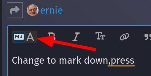

I selected the garuda-inxi output in my post and clicked the “Preformatted Text” button, but for some reason it didn’t work. I’ll try to be more careful going forward.
Ernie
Change to mark down,press
