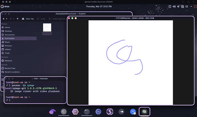

Briefly tested in a VM, qimgv-git (chaotic-aur) and qimgv-qt6-kde-git (AUR) works w/o any issues:

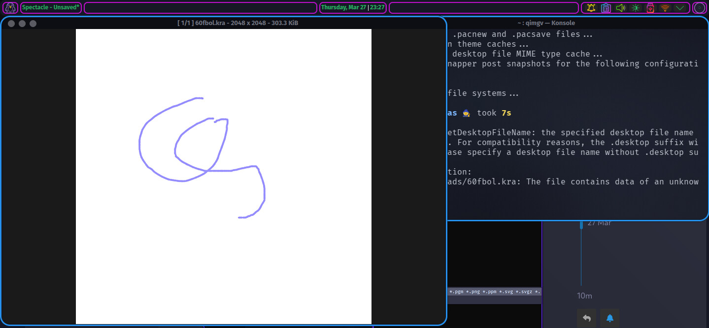

just reboot and installed on my Kde worked without issues on my metal machine :wink:
Little off topic tip: KDE’s gwenview can also open *.kra files.
btw: it is not a good idea to test unknown files from strangers on a productive machine. For this you should use an isolated VM.
worked on Kde :wink:
